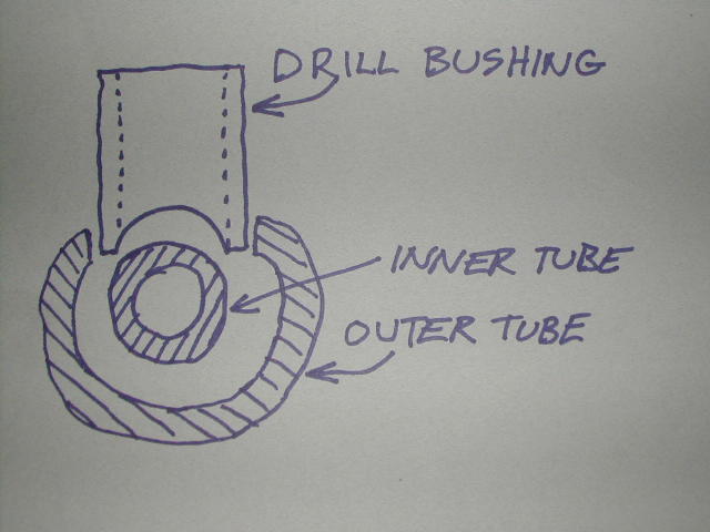

Attached is a drawing of a larger diameter tube with a 3/16" hole drilled thru both walls. It is slipped over a smaller diameter undrilled tube. I would like to drill a 3/16" hole in the smaller tube and have it align with the hole in the larger tube. I cannot slip the two pieces together and drill them all together for two reasons; I want to use my drillpress, the outer tube is on the fuselage and I don't know how to locate the center of a drilled hole. So...
I can scribe a circle on the smaller tube, using the hole in the outer tube as a template.
The question becomes, how do I locate the center of the 3/16" hole drawn on the smaller tube?
If I had easy access to a lathe I could build a punch with a diameter of 3/16" and a centered, very small tip, but I don't have easy access. Looking for an alternative.
Thought of drawing crosshairs on a piece of wax paper, then drawing a 3/16" circle around it and centering that drawing over the scribed circle, but wondering if I'm overcomplicating the job. - Mike
