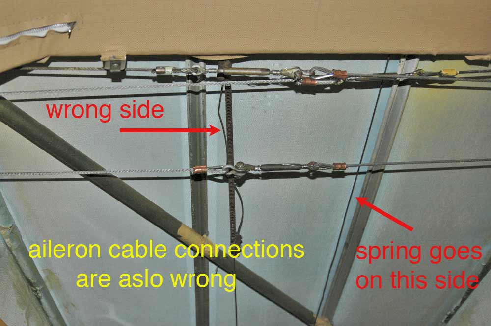

        I have fixed that same problem on a few Tcrafts. What I did was access the and remove the trim cable from the fwd pulley. You can pull fwd on the cable and slip it out of the groove and off the pulley. This will remove all the tension from the trim cable system. Now you need to remove the 2 elevator horn access panels at the tail of the plane. Now you can turn the aft pulley by hand until you get the trim tab back to neutral. You will have to also run the fwd pulley to the neutral position if you have the trim position indicator still installed. The trim indicator mechanism will bottom out on you and stop turning,then turn it the other way until you hear it clicking. That sound is it skipping off the threads at the top of the crank. Now crank it back the other way about 2 turns and figure on that being the end of travel. Now count the number of turns back down till it stops and cut that number in half. Look back behind the baggage area where the trim cable runs between the rear spar carry through and the 2nd cross tube back from there. The pilots side cable should have a spring on it to keep tension. At either end of the spring are clamps holding the cable to the spring. Make sure this whole setup is centered before re installing the cable on the pulley. Turn the crank back up the other way now to the 1/2 way point and re install the trim cable back around the fwd pulley with the tab in the neutral position.
        There is a small hole to lube the bushing where the jack screw shaft goes into the left elevator for lubricating it. Its real close to the pulley. You may have to scrape some old paint and gunk out of the way to find it. There should be an inspection cover on the bottom of the left elevator that you can pop off and squirt some lube into the jack screw its self.
        If your headliner prevents you from accessing the fwd trim pulley you can loosen the cable where it attaches to the spring to relieve the tension. If your spring is on the other side(short run between cable guides) you need to move it over to the pilots side so you can get the right amount of trim tab deflection.
