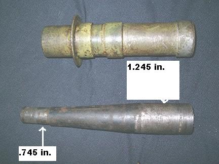

            1) What are the bearing bores for the inner and outer bearings on the factory spindles?

              John, I put the calipers to a standard, tapered axle that was cut off of a BC12D gear...Got .745 inch at small end and 1. 245 inches on the big end. The item above the axle is an adapter that fits over the axle and inside the bore of a ski pedestal. Dick
