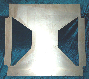

      As promised, pics of our Sky-light mod.

        I understand how it fits, Chris, but how is it cut out? Can it be done "by hand" or is it necessary to get it punched out by some phantasmogorical CNC puncher?
        • #19
          It was all done by hand. A cleco is lined up, and each hole was drilled. The one shown is still cleco'd to the master! A lot of work to say the least. I have 3 good ones right now, and a few old ratty ones for pattern and installation reference.
          The sky-lites had frames that were them screwed to the aluminum.
