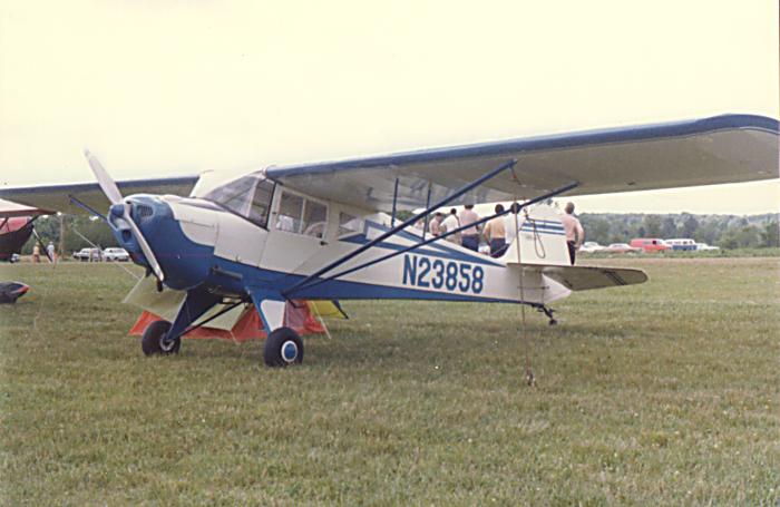

Howard:
Is that nice panel picture from N23858? I just checked and she is on my web page at http://taylorcraft.info/tcraft/23858.jpg from 1980. Did you have her then?

I see you just posted the pics I sent of 20442, thank you. 23858 is in pieces in two barns on the farm here. I was thinking of doing a restoration photo site on her, but you and Rob Lees are tough acts to follow!
I didn't own 23858 in 1980, I believe the fellows I bought her from (Dave Reist) and his dad were the owners then.
