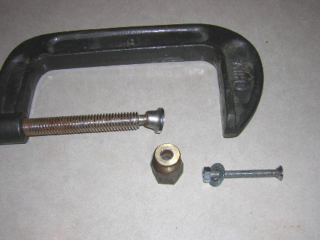

      I made my own tool(s) by doing the following:
      Poke the sleeve thru the hole in the cowling, (preformed side to the outside of the cowling) then "flare" the inner end of the sleeve using a 1/4" stove bolt with a tapered head. Place a washer between the nut and the preformed flat portion of the sleeve. Simply tighten the nut on the other end of the bolt with a wrench to start the flare using the head of the bolt. Flare it about 45 degrees. Remove the bolt at this point, and the partially flared sleeve should stay in the hole. Next, put the DZUS stud into the partially flared sleeve, and use a homemade bushing and a c-clamp to finish forming the sleeve around the DZUS fastener.
      My "homemade" bushing was nothing but a 1/2" pipe plug I had laying around with a 5/16" hole drilled thru the center of it. The 5/16" hole fit a #5 DZUS fastener, but you can measure the diameter of the stud and drill that sized hole in your homemade bushing to fit it.
      Let me know if you need some photos, it's kind of hard to describe.

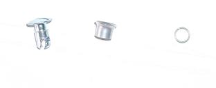

              AJ5-40 - Fastener
              GA5-312 - Grommets
              SR5ss - C-clip

                    Re: Dzus Repair
                    Great pictures...they do make it a lot clearer. I was trying to do it without buying MORE tools. I can hardly get in and out of the shop as it is.

                      Here's a poor man's DZUS installation tool kit.
                      John 3728T
                        Re: Dzus Repair
                        Which is #1, 2, 3, and 4?
                        Seriously, do you just push on the head of the fastener with the ram of the C-clamp?

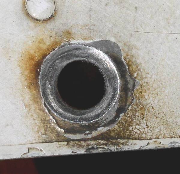

                          These posts were very helpful in figuring out how to repair the dzus fasteners on my cowling.
                          This site has a bunch of great info as well for anyone else working on these: https://www.milspecproducts.com/z_sp...s__compatible_
                          They also sell the fasteners and tooling.
                            If you have a hole worn through your cowling, rivet on a doubler INSIDE the cowl and use flush rivers to hold it in place. You also need to make sure that the spring tension is correct for a dzus to not come loose or fall out.
