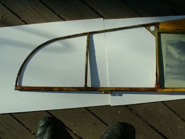

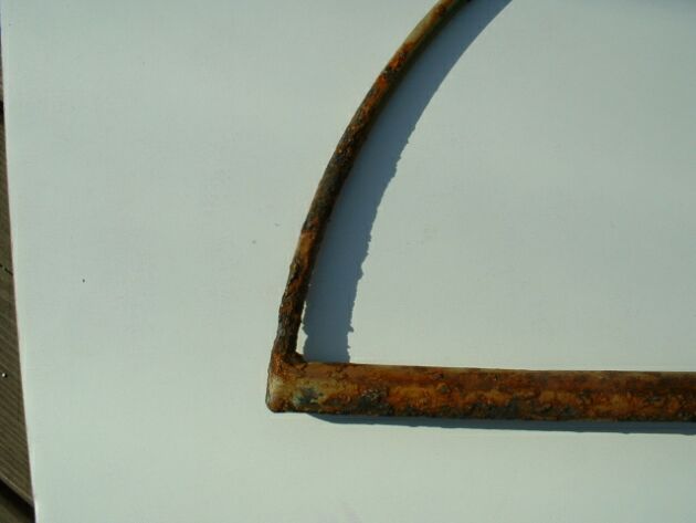

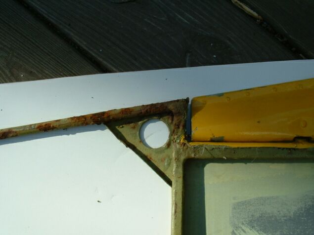

    I opened the elevator for 88M; attached are the pics.
    My mind set was based on the restoration pics on Capt.Jon's site, so this was expected and not a real shock.
    Next, I'll strip the paint, and see if the rust can be wirebrushed off, then visit my A&P.
    I'm thinking at some point we'll need to decide if it would be cheaper to simply purchase another elevator rather than attempt to repair this (and other parts, no doubt) - Mike (really, not discouraged; I expect worse)

      Just on those few photos, Mike, I would repair by replacing the aft curved tube.
      Also: don't wire-brush. Only bead-blasting will tell you what's underneath. Purchase a cheap beadblaster, some bead (walnuts, etc), a few paper overalls, some goggles, gloves, mask etc (you get the idea) and have a look under the rust.
      The risk with spending money on a replacement is that you might not know what you are buying. Then you might have two duff components. At least with 88M you know what you have got.
