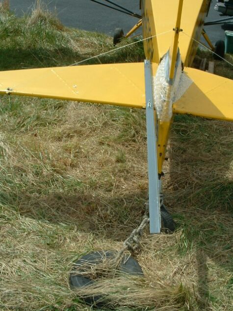

Among other things (chase the wasps out of 88M), I almost completed removing the tailfeather. The horiz. stab. is held in place with two tubes jutting out from the fuse and slipping into the horiz. stab and held in place with bolts.
The forward set of tubes is loose in the stab., but the aft tubes are a different story. Rusted tight. I soaked them with liquid wrench, set up a vibration and did a variety of other things including taking advantage of the wiggle room in the from tube; placed a wedge there and tried to force the trailing edge forward. No luck.
Anyone had this problem and can offer a fix? - MIke

. Well, I'll go back Sunday and try again. - Mike
