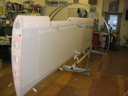

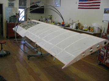

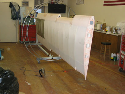

          I move wings around the shop usually with 2 people, the wife and me. But I've also moved them solo quite a bit. For solo I have a 12 ft. long wing storage "shelf" bolted to the wall. The shelf is the same height as my sawhorses so I can slide the wing horizontaly off the sawhorses until the leading edge is on the shelf...then tip it up vertical and lean it against the wall.
          Once you get the cover off don't use sawhorses, instead clamp the wing in a vertical jig with the leading edge up and the trailing edge about 6 inches above the floor. Then you can work on both sides at once and do a complete disassembly, replace the spars, and re-assembly without ever taking it out of the jig.
