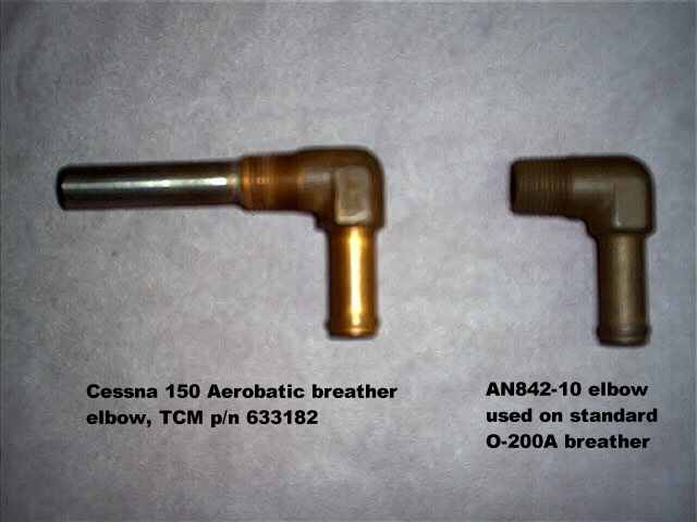

        Here is the extended tube on an O-200 that someone mentioned. A nice fellow out in Washington sent this to me....also see this link he sent

                            Has any one on the forum ever done a 337 for installation of a crankcase air oil Seperator, the are some available from Aircraft Spruce, there may even be an STC'd one for a 65hp from Air Wolf but the price is astronomical.
                              Search for "aerobatic breather" mod.
                              turns your breather crankcase fitting into an oil separator.
                                Thank you Scott, noy yet sure how to do this, but can read it again.
