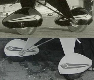

      Re: Wheel Pants/Fairings
      Like these?
      • #33

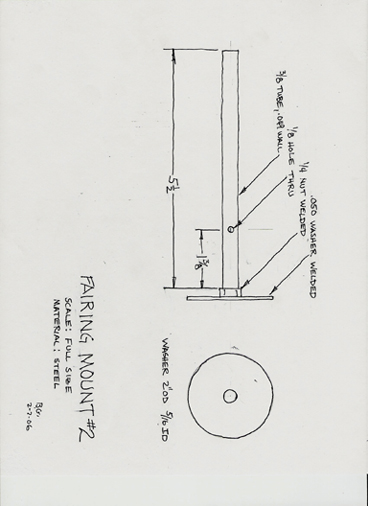

              Forest,
              Are drawings available for the welded up wheel pant mounting hardware?
              Ray

                        Attached drawings of the wheel pants mounts for folks who'd like to make their own. Mount #1 shows the right side part. The left side is the same except the 1 1/2 x 1 7/8 "U" flange is welded on the other side of the 6 hole part.

                          Yes those are the 2670-3 & -4 shown on the F-19 Parts & Price list. page 14. the reinforcements shown below on that page are merely blind nuts on two plates to aid in the install. A Taylorcraft Foundation member is having them shipped to him from here tomorrow.
                          He will duplicate on a CNC machine & they will be available to owners from him or here in Alliance . For the owner to fabricate, he will merely have to weld the tabs in place. Use the drawing or e-mail me direct to be on the list for ours to be ready in about two weeks. Tomorrow I will list pants available and sources. Harbor Ultralites may indeed be gone!
