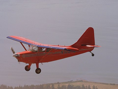

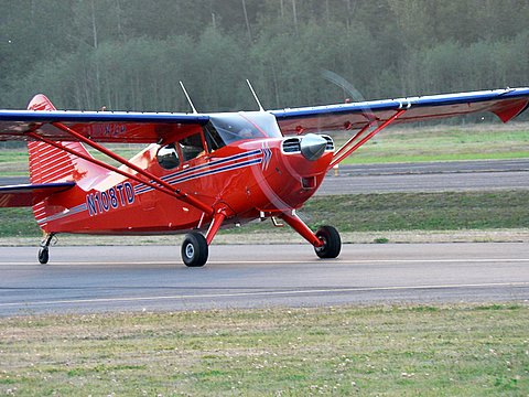

    Looks good Lee. The wierdest ones I've put on so far have been on a Stinson, as you have to move them back toward the aileron, because of the slot in front of the aileron. I'm looking forward to the "pilot report". I always tell my customers that they're not supposed to be a "stol kit" but rather an enhancement of control at low speed...

                I talked to a guy a while back who had put them on his Maule M4....he was unhappy with them, thought they made the stall speed too slow. He liked to fly a faster approach and he said they made it float if he didn't slow it way down. Really.
                How well did they work on the Stinson? My brother and I have debated putting them on ours. WE do like to fly slow approachs....much better when landing "off-airport".
                  Re: Pics of VG install on wings
                  They worked wonderful on the Stinson! Well worth the money. It's good without them, but even better with them!
                    Nice Stension
                        That is a great looking Stinson! Which engine are you running in that?
                        Do you have any kind of before and after numbers on the Stinson with the VGs?
                        They are a temendous short field performer if you fly them right on the numbers, but it'd be nice to have some margin.
