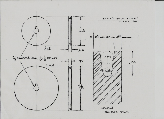

Does anyone have the dimensions for the rear BC12D trim pully? My mechanic replaced mine last annual, but since Taylorcraft in Texas couldn't ship one
, he bought and filed a keyway into a 2" OD pulley from Airspruce.
To make a long story, well longer.... My trim cable slips in the wide groove in this new pulley.

I read that there is more grip if the cable is supported by the sides of the pulley, not riding in the bottom, so I bought some 1/4" thick Linened phenolic (Textilite?) and easily turned a sample, now, I would like to make it to spec.
The dimensions I need to clarify: OD (2"?), cable depth from OD (1/16"), center hole diameter (3/8"?) and keyway dimensions. I am hoping the thickness is 1/4".
Hopefully, someone out there has one that isn't in their airplane and can make some quick measurements.
Also, in general, would it be possible to place drawings in this web site of common 'owner supplied parts' like this
. I would be happy to generate drawings in .pdf format for this purpose from old parts or paper drawings. Just a thought!
