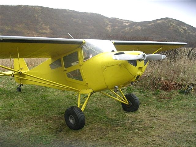

    Jason Gerard put 26" Bushwheels on his plane Here...he didn't change his rims. I have 7.00 x 6 on mine....Here works very well.

            Dano"T" - The pics are great. What I'm looking for is something in between the two. Something that has a decent height/width without looking TOO tundra-like. I want to be able to safely land on crop stubbles/unprepared permanent grassland without without worrying.
            I must say I get confused by the two different measurement methods for tyres these days. What i'd like is tyres about 20 inches high and 8 wide. Is there such a thing?

              My 800x6 measure 19" high and 8" wide.
              Anybody have a set of 850x6? How high are they?

                Don, my 8.50 x 6 measures 21.5 inches in diameter. 8 1/2 inches wide. The right hand pix shows 8.50's mounted. The left pix shows 29 inch tires mounted on a Taylorcraft with a Cub cowling setup.
