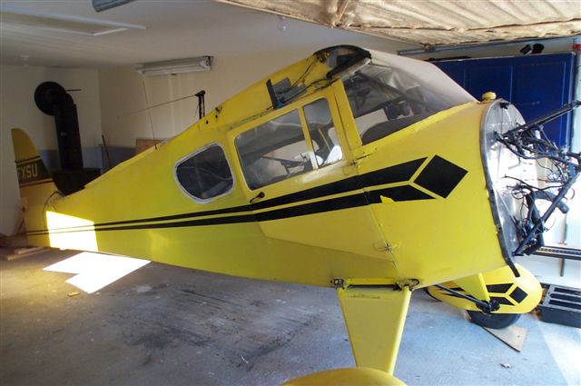

                    Bill,
                    I think I know exactly what you are talking about and I think I am going to be facing the same problem. My aircraft is a 1951 Model 19. You can see in the attached picture the airplane as I purchased it prior to rebuild. The two lines you see outside the cabin in the wing root area are the fuel line and vent line. You can see these lines run forward between the wing root and cabin to the windshield area where they enter the cabin. My fuel valves for the wing tanks are under the panel around the knees of pilot and passenger. I assume this was the original config for the Model 19. After I recovered the fuselage and did a test fit of the wings (prior to cover), there was very little clearance between the wing root and cabin on the right side. Obviously I did not get the door frame mounted exactly as it was originally. It is going to be very questionable if I can fit the fuel line between cabin and wing root and I can't run it into the cabin as the upper door frame lies right where the fuel line would enter the cabin. My one saving grace may be that when I shrunk the fabric on the wing, I believe it pulled the root rib inwards enough to create the clearance. There is a 90 degree fitting from the wing fuel tanks right at the wing root.
                    I know I haven't helped you any, but at least I know exactly what you are talking about. Do you have enough clearance to run the fuel line forward between wing root and cabin? If so, maybe you could do that and install the shutoff valves under the instrument panel as I believe is standard for later model Taylorcrafts?
