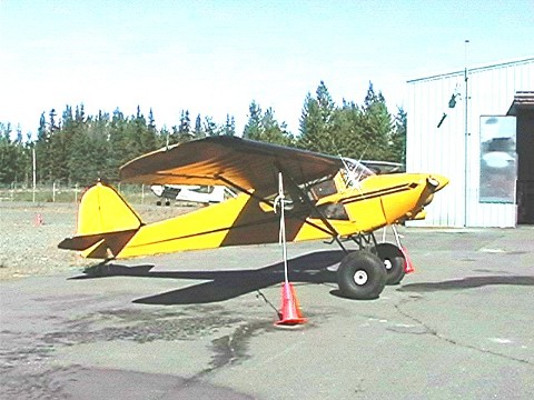

    cabane/maule shock pix
    Rob, here is a pix of an F-19 with the cabane/shock setup.
    Dick

      cabane/maule shock
      Rob, sideview of above-mentioned plane. Dick

        Thanks for posting the picture of the Yellow Tcraft. I remember seeing that ship in front of a house on the big runway at Port Alsworth in 2000. That Cub style gear and Cub FWF looks really good on it.
