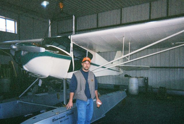

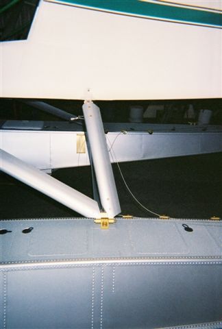

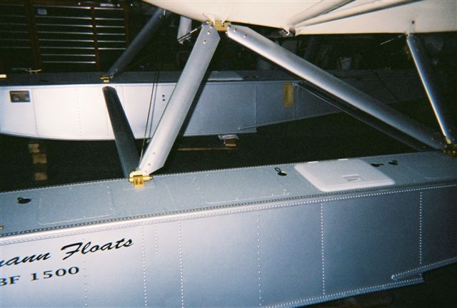

          Are you guys still on floats? I guess this will be the last hurrah, by November the ice is forming and the skis come out soon. I have a new set of Baumann BF1500's on my plane now and when the FAA flight test is complete later this week I'll post more to update all of you fellow float guys as to the status and performance of the Taylorcraft on the new Baumann's. They are shorter than the old BF-1420's...they are now the same length as an Edo 1320, but are 1" wider and 1 1/2" deeper giving a 1536# displacement per float. They have pump outs and option of 1 or 2 storage hatches per float...they have fluted bottoms just like the 1320 and water performance is very promising....Joe Birkemeyer at Baumann is tweaking them now for optimum performance, he's playing with the rear strut length to find the best angle with respect to the airfoil. Total installed weight is 190#. I'll post more when we have the final set up....Here is a picture or two (I didn't have my digital so picture quality is poor)
