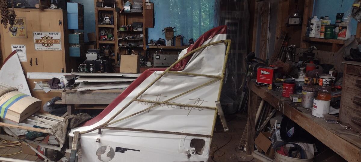

    The vertical stabilizer has a bent tube. Just so happens it's the tube that makes the curved part. Well, It needs to be replaced, and I need to get a curved piece of tubing. They don't sell curved tubing, (But it could very well be curved by the time it's shipped to you). So, I started calling fab shops, in hopes of finding someone who could do a proper bend. I didn't realize that there are so many companies out there that do nothing but bend tubing. I called about 8 or 10 of them, and found no one that could bend my tube. They don't have the rollers for 5/8" tubing.

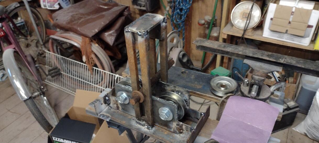

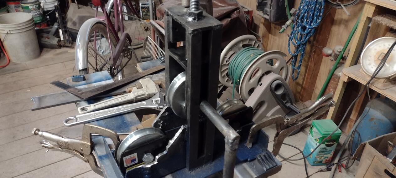

                  It's the curved part of the fin, from tail post forward. I got the bender made. but on test drive, I found that the wheels need some adjustment. But it does make a nice smooth bend with 4130. I didn't get any pics, but will have some in a minute or two
                  Thanx,
                  Shorty
                    Here's a couple of pics.
                    Thanx,
                    Shorty

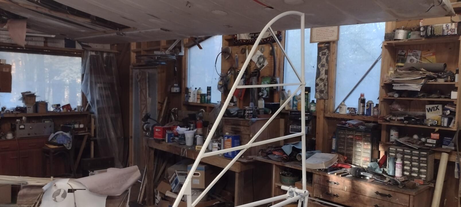

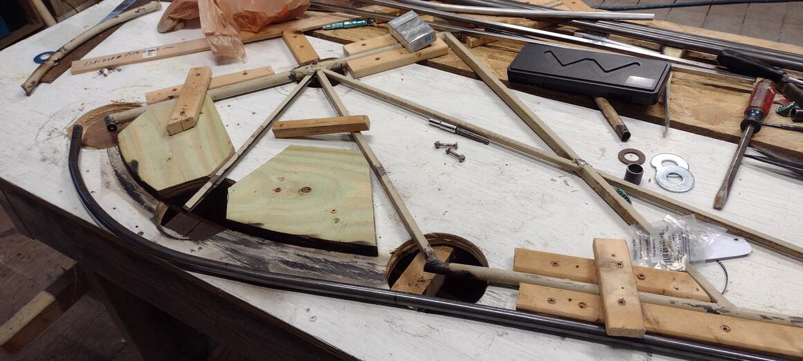

                      Got the roller lined up, bent the tube, and installed it today. got it blasted, and primed.
                      Went from this:
                      To this:
                      I would hazrd to guess time spent on the roller/bender was well worth it.
