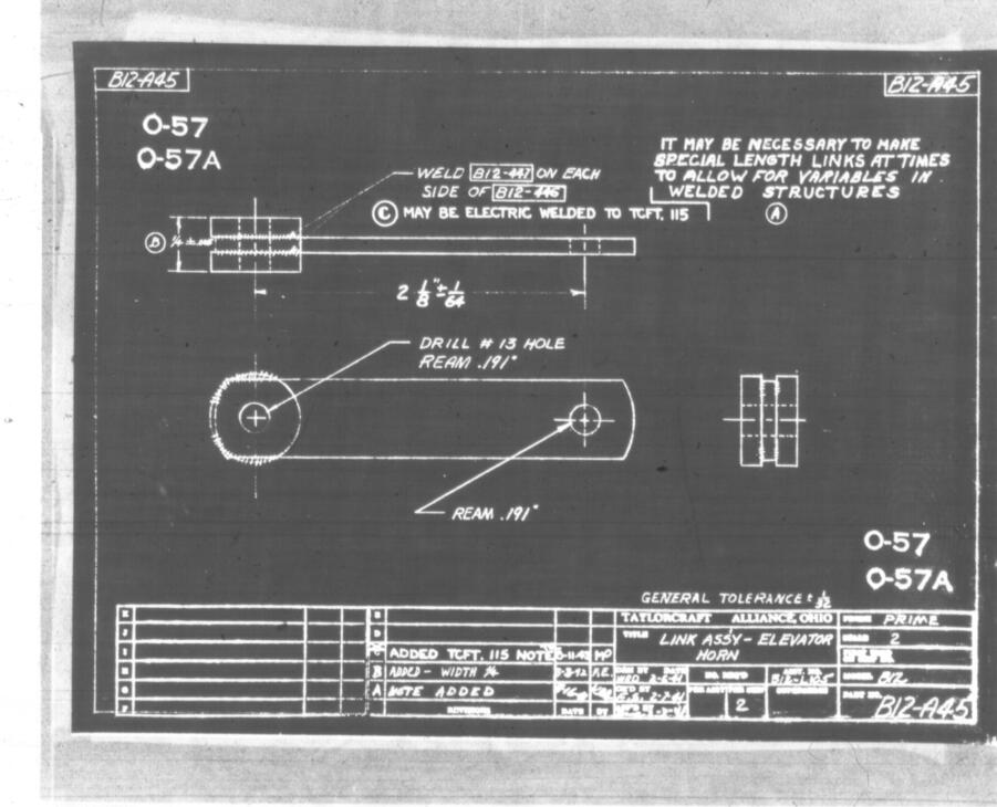

    I have found the drawing of the end fitting for elevator cables as ours are missing - Any idea of the material it is made from ?

    Originally they were probably 1025, but 4130 would be an acceptable replacement.
