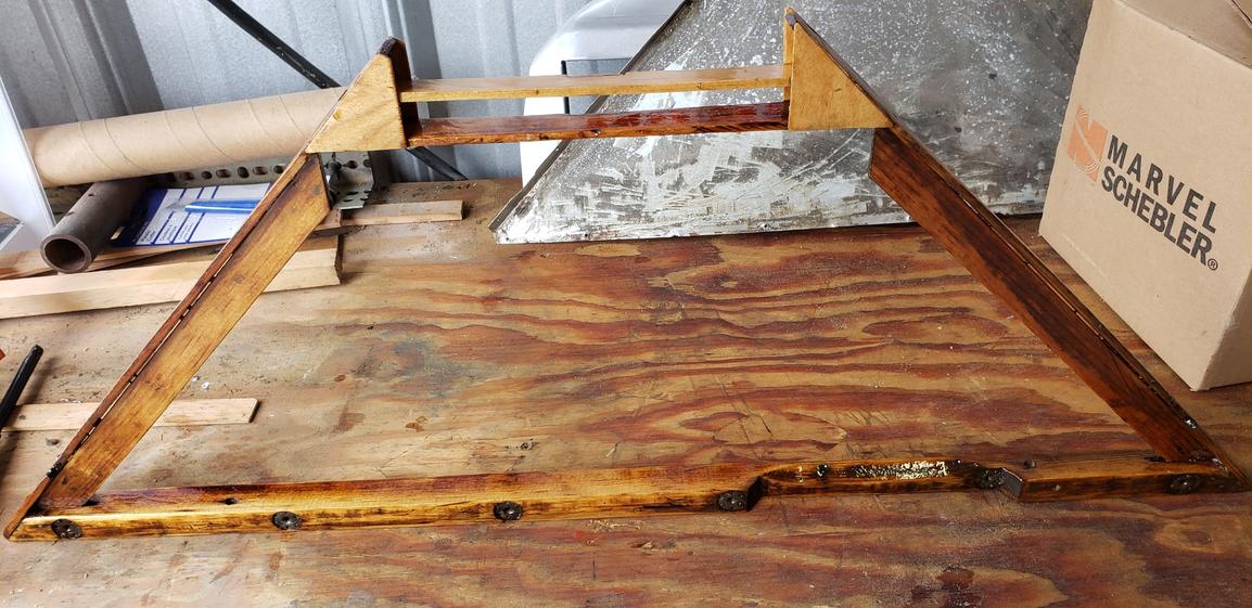

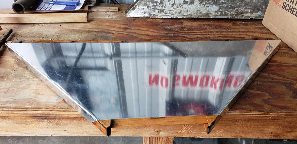

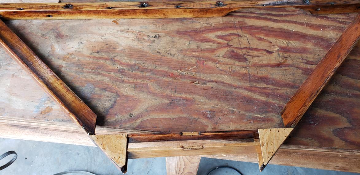

    Before (bottom pic) and after pics of the triangle between the gear. It needed a new piece of wood put in as the old piece was cracked. Then new gussets at that piece attach point on both sides. Complete sand and recoat with two coats of spar varnish. Then new aluminum cover plate fabricated. The old one was getting really rough and had a stress crack just beginning in a corner. One more part in the series of parts either new or rebuilt ! 20220128_115800.jpg20220128_115800.jpg . Good for another 76 years. Now on to hang the 0200 and some misc doodads so a professional metal man can fit up the new boot cowel cowling and nose bowl. 20220128_115736.jpg20220128_115930.jpg20220104_124942.jpg
