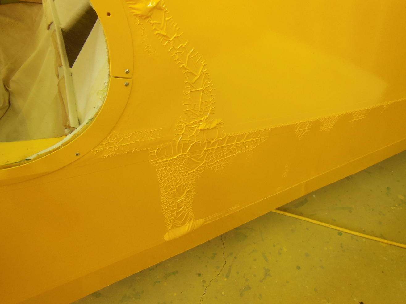

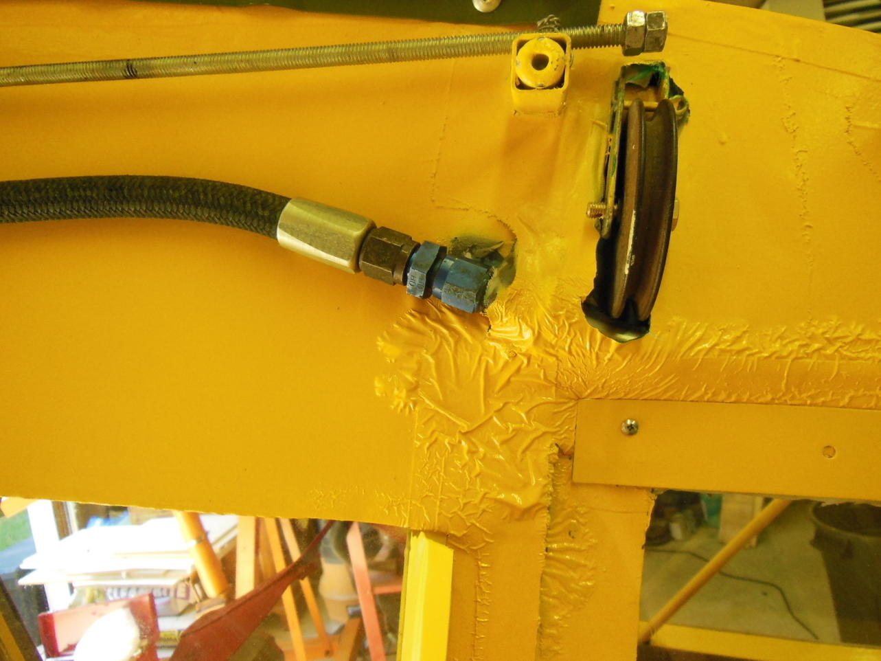

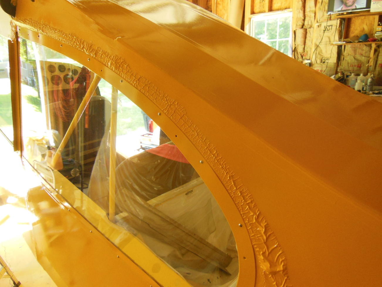

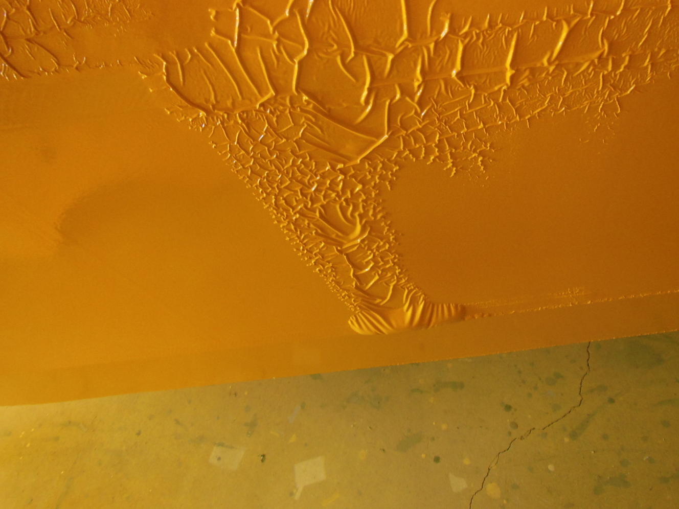

    I used Stewarts and loved it until some fuel leaked and half of the left side of the fuselage was really messed up.
    They say it's fuel proof, be careful.

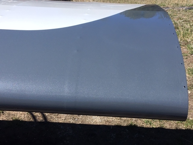

      I rebuilt my wings in 2014 with Stewarts. I painted in early spring with the hanger about 60 degrees and more important I think at 7200 MSL. Low vapor pressure at that altitude you see. The fill coats are a breeze even using a cheap Harbor Freight gun. And it is wonderful to not have to wear a moon suit to avoid MEK fumes.
      The final finish coat (eco-poly, Insignia White) was more trouble. I have a good DeVilbis s gun and the finish paint really wants a good gun. My tests following their instructions resulted in lots of orange peel. I think the high altitude and minimum temperature were both a big factor. Thinning a bit to a few seconds less from the viscosity cup, adjustment to the gun for a bit finer sprey, and four instead of three coats made a big difference. My wings have a little orange peel looking closely, but no more than I see on other paint jobs.
      Since then I have done some smaller jobs with both eco-poly and eco-cryllic on metal and the bit thinner paint for the altitude with more normal temperatures have resulted in good shiny paint. I do think that eco-cryllic in particular is a bit more fussy than other finish coats.

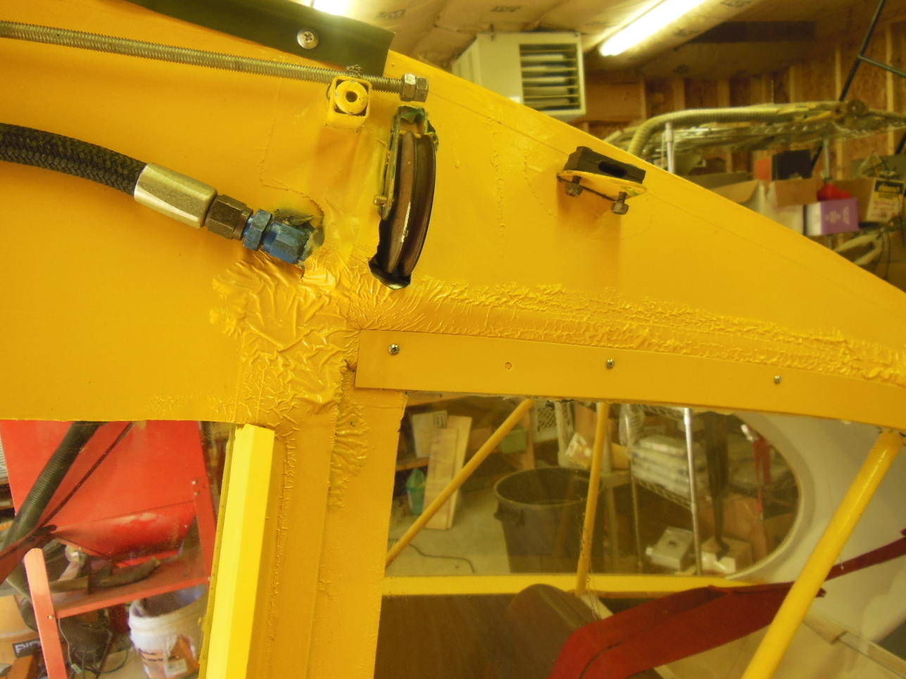

        Skip I do not know why. I did strip it off and repair, looks poor, but I do know this for sure- it is not fuel proof.
        One could say its all my fault for have a loose fitting that weeped, but it is not fuel proof.
        I am careful not to spill and I clean off what spills when I do.
        I would probably use it again.

          Dave,
          Looking at you pictures it looks like the fuel went down the inside and attacked the paint from underneath. So my experience running fuel over the outer paint coat shows that it is indeed fuel proof from the outer surface. However getting fuel inside and underneath lifts it! That is really good information.
          I notice that Stewarts changed their STC instructions last year to have you do an initial fill coat of their glue before the eco-fill spray. I was puzzled by that as the eco-fill seemed to fill the weave just fine. I wonder if addition internal fuel proofing was a part of their consideration and they just changed the instructions without telling us why?
          Thanks for posting the pictures!

            Darn! If I had known that I would have put the leak on the outside! LOL :-)
              SOME auto gas will lift it, like Dave found out. Most wont. Andy has samples that have been submerged in 100LL as well as auto gas for over a year and they're fine...other samples from other sources of car gas lift quickly. All that being said, I have seen the other systems have problems with certain fuels too. The manual has been changed to caution people to not use autogas to initially test the system.
              The filling the weave with the Ekobond was the way it was done originally, back when I was part owner of the system. We didn't like to fill with Ekofill because there was a higher chance of moisture entrapment and blistering if the conditions are right. When Stewarts bought the system, they changed the procedure to an initial fill coat with Ekofill over moist fabric. The other problem came from people not quite understanding the procedure and wetting a whole wing, then brushing fill in. Often, by the time they got to the end of the wing, the moisture had escaped the fabric and they wound up with an adhesion issue. So, as you said, Andy took the procedure back to what it was in the 90's.
              If you're going to be using auto fuel, they recommend a brush coat of EkoPoly Premium, on the bare fabric in the tank area, then apply the seal and fill coats as usual.

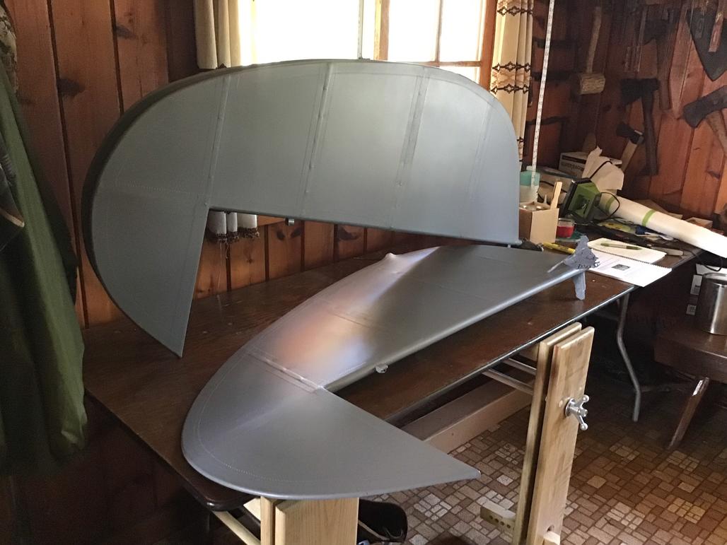

                              From a user perspective, the Stewart System is fantastic and hands down, the BEST system available. I wish the lingering animosity towards the name would go away. I have two sets of new Airframes Alaska PA-18 control surfaces covered thru EcoFill (silver) sitting in AK that most shops wont even look at when I mention Stewart Systems.
