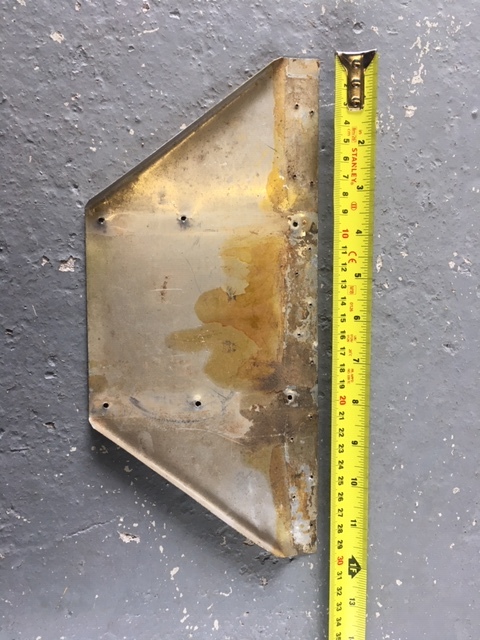

    Can anybody tell me what part this is please from a BC12D?
    One each goes top and bottom of the aileron at the centre hinge. The tiny punched holes are for nails to the aileron spar; the larger ones are for PK screws down the ribs.
      Thanks Rob
        If re-using the same piece in the same location on the same spar, don't use the same nail holes!
