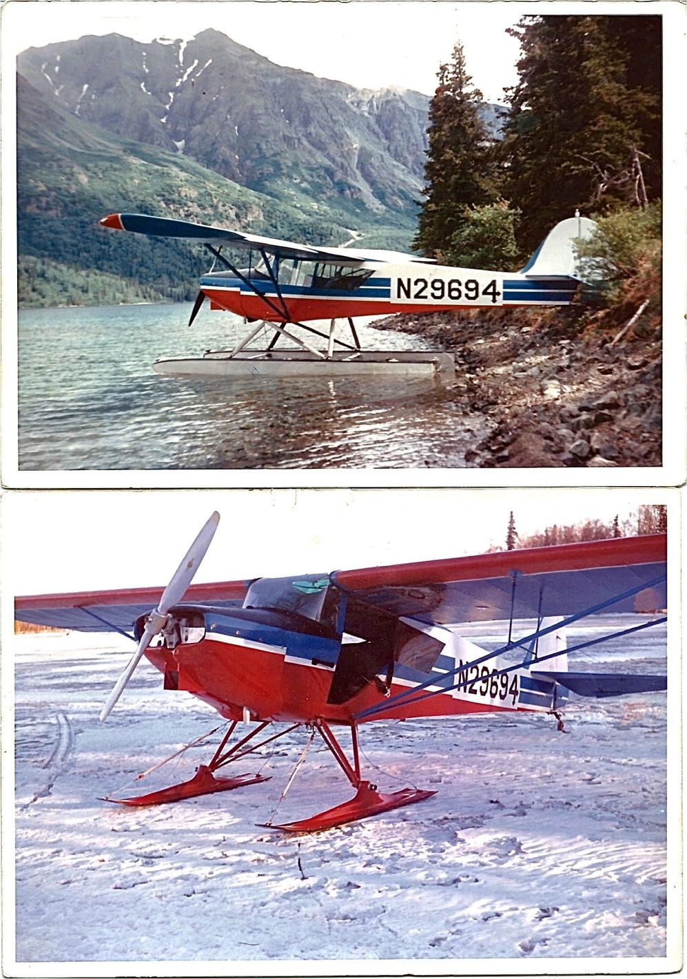

                Here's another factoid from 1941...my first Taylorcraft N29694 with Continental A-65 was built 1/1941 under Production Certificate #9. CAA Form 307 and 317 prior to TCDS A-696 being noted were applied. A temporary Certificate was issued and A-696 later appears on paperwork in mid-1942. My current plane N36007 was produced and certified under TCDS A-699 in 6/1941 with a Franklin engine and includes CAA forms ACA-309 mentioned in #18. In 1982 a Continental A-65 replaced the Franklin and the FAA issued a new Airworthiness Certificate calling it a BC12-65. Whatever.
                Gary

                  We have 29654, also built January 1941. It is not that the A-696 type certificate wasn't there yet, but rather that the BC12-65 had not been added yet.

                    Thanks Tom for the information on N29694. It's still a local plane owned by an A&P/IA who's day job keeps him busy. I hear it's being restored. At one time it had an O-290-D2 in the front after I sold it. Lots of mods on that plane when I had it. C-85, Beech-Roby, extended rear baggage beyond SA1-210, Enlarged side glass, Arctic Tern cowling and squared off wing tips and ailerons.
                    Gary
