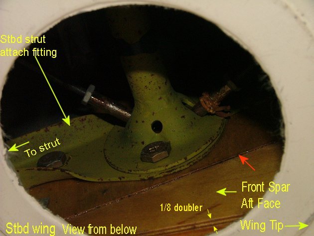

        Here is my photo of the front strut attach at the spar of our 1989 (yes, 1989)F22. Sorry about the poor view; it's taken through the inspection hole.
        My measurements make the front spar 3/4 thick, with 1/8 doublers. The red arrow highlights an additional doubler, approx 1/32 thick (i.e. wafer-thin). It appears very similar to the Harer drawing to which both Don and Bill refer.
        This 1989 F22 aircraft is approved for 1750lb gross weight, both here in the UK and the USA.
        Amazing, since it appears the spar is the same thickness as the 1939 B models of 1150lb gross.
