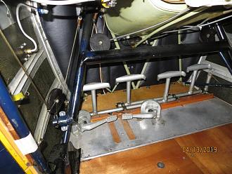

    I installed a set of Scott hyd pedals and Cleveland wheels and brakes in my 1941 BC12, Got a field approval for the setup. They are more than I need but they work great with 850/6.
    Norm G
    Click image for larger version  Name:	IMG_1567.JPG Views:	1 Size:	154.0 KB ID:	183481
    Ugh, those scott's suck to work on compared to a Parker/cleveland/cessna master cylinder. I hate original piper brake stuff to work on...oh and when your header tank valve starts leaking, give me a shout!

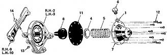

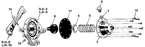

      Hmmmmm.....I had the Scott masters shown on three Cubs. The only maintenance was periodic replacement of the diaphragms as they aged and maybe stretched. Keep them bled of air and pull the pedal back some to maximize fluid fill if needed. Low tech and pressure true. Make sure the brake lines can't expand under pressure by using proper quality parts.
