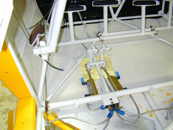

A test to see if this thing works - showing off my hydraulic brakes.Attached Files

My plane is a '49 and had the 1-1/2 axles when I got her. I put cleveland 30-75? brake calipers with the cleveland wheels, used the 10-30 master cyl. as seen in that picture, and they worked well the few times I tried them out, as I'm usually on floats or skis, plus I put in a parking brake valve- with a cable control- I'll try to upload a few photo's when I can, but haven't yet figured out how to adjust the size on the Mac here. Thanks for the comments!

I've been away from the "Surfin" machine here for a while, and still need to figure out how to resize the pictures for uploading. But to correct myself, the wheel brake caliper's are 30-55, not the '75's, although those may work fine. While doing the work on the mod, I often wondered where Taylorcraft got those parts to make the pedal itself. The pad looked like something like a friction-lock plate that held a carrige bolt - squared shank bolthead, and that was braised to the fulcrum arm, which was probably another tractor part as it looked to have a pin hole off center the pivot hole for a locking pin for something - I think they where original as the plane had 1300hrs on her when I got it, and never had much done to it as far as records go. I'll keep trying to figure out how to resize those picture, -old dog trying to learn new tricks!!
