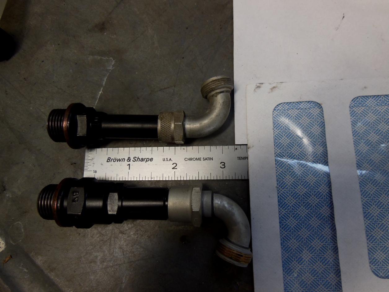

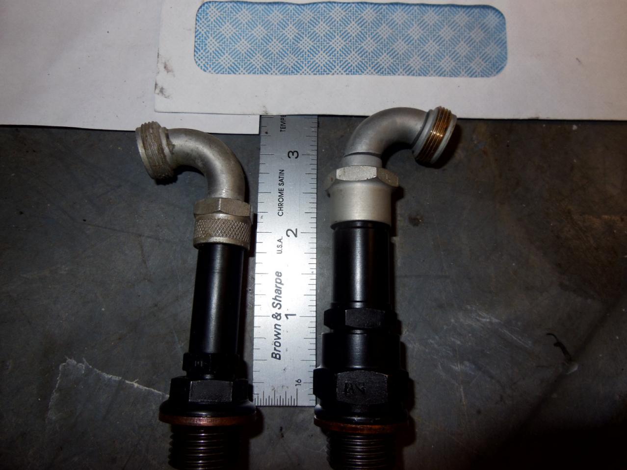

Scott,
I attached some pictures.
BG 4B2s is about 5/16" shorter including the elbow.
The plug next to it is BG 919SR-5. 4B2s plugs use a smaller elbow.
I have a NOS set of plugs and elbows on the shelf. Elbows are very easy to swap out on the harness end.
There are some plugs on ebay => https://www.ebay.com/sch/i.html?_fro...+4b2s&_sacat=0
I got mine from Lou Liebee. Fresno Air parts should have plugs and elbows.
