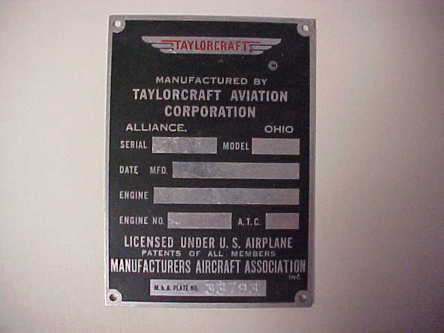

        The "dataplate" will not show which engine, only the manufacturer. ie Lycoming, Continental , Franklin and the ser# not "A-65" etc..
        this is a genuine blank 1940-41 plate....
