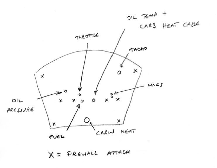

    I have a bunch of tubes / cables / wires / etc under the dash and a bunch of holes in the firewall . I would like to match them up. I need a picture or diagram 96755

        Re: firewall
        Here's what my firewall looks like (1946 BC12D)
          Re: firewall
          N96755,
          My 46 BC12-D has been rebuilt a number of times and is being rebuilt again.
          My firewall has a few more holes in it than Robs.
          My oil temp and carb heat cable each have there own hole side by side.
          I have a primer to carb line hole next to Robs fuel line hole.
          The primer line from the fuel strainer goes thru the firewall just below Robs mag switch holes. My heater control cable is right in the middle of the firewall just below Robs fuel and oil temp hole. My mag wires are also up by the tach cable, however I do have two unused holes where Robs mag wires go thru.
          Just more info to mess up the picture. Hope it helps a little.
