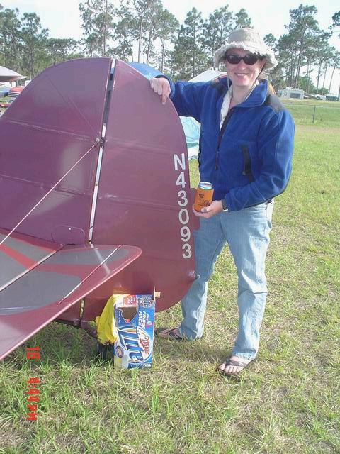

          While there at Sun N Fun I became an inventor...A turbulence indicator (bobble head dog) and I designed a great rudder gust lock...worked fine until the night wore on....

              Taylor Maid,
              Nice bird.I like the rudder stop idea but like you said,it wouldn't work very long around here either.
