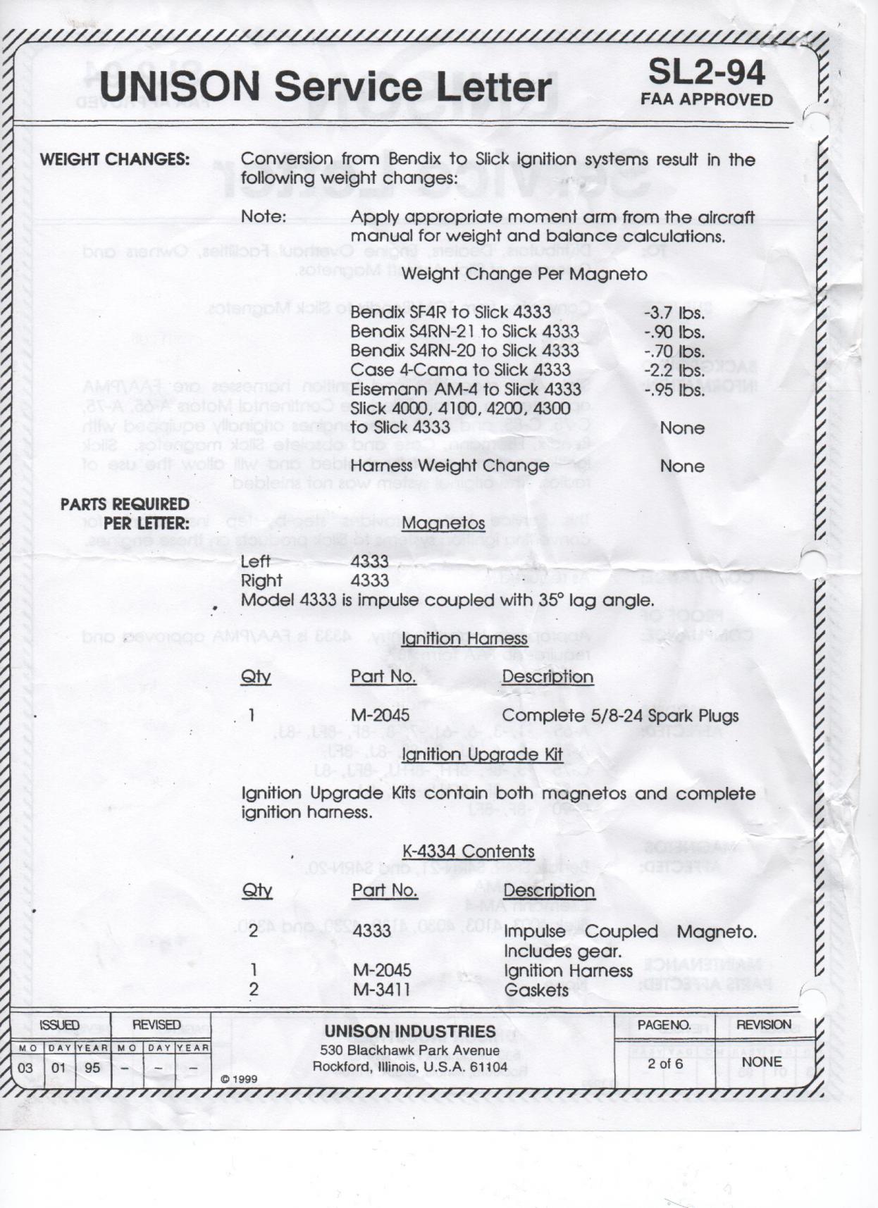

                      Can you say the before and after brands you're swapping to gain 7+ lbs? (edit: of useful load)
                      Right here in black and white, and now my bank account is red all over.
