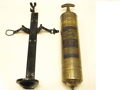

    Would anyone have pictures of both the "American White Cross" first aid kit and the "Fyr-Fyter" 1 qt. extinguisher that were installed in the L2's?
    I've located both but don't know part #'s, if there are any and would like to be sure there what I'm after before buying them.

    I was told this was the fire extinguisher in the 41s. If you find one, be VERY careful that is is cleaned out. The original chemicals used in them were pretty toxic.
      Re: L2 first aid kit
      Thanks Hank. Seen that style, but the holder is usually missing the clasp portion.

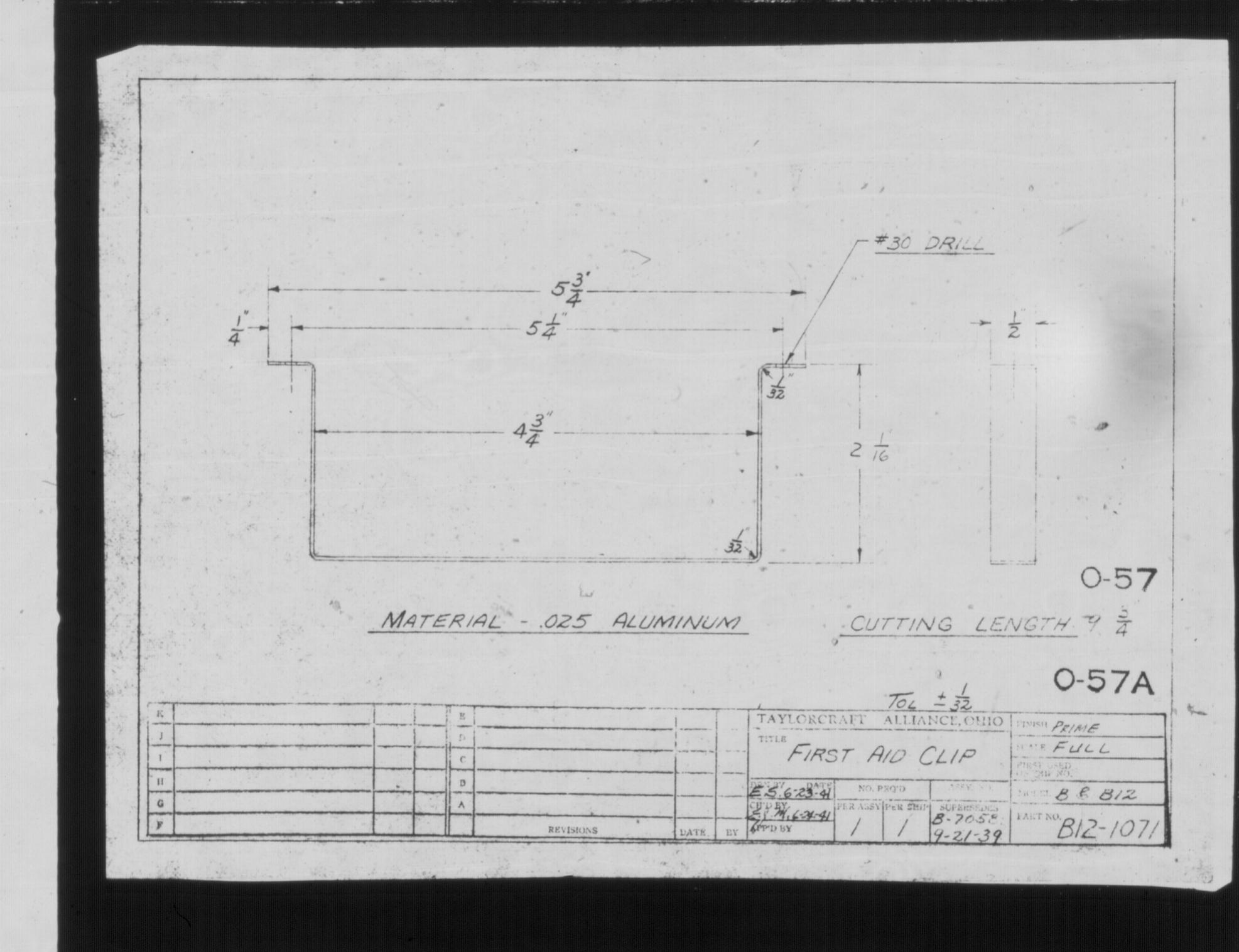

        Looking through the parts manual the part # for the fire extinguisher is Model #10 and pg. 109 has an illustration. The first aid kit part # is Emergency and page 116 has a poor illustration. Part # B12-1071 is the first aid clip and its dimensions should provide some clues as well.
