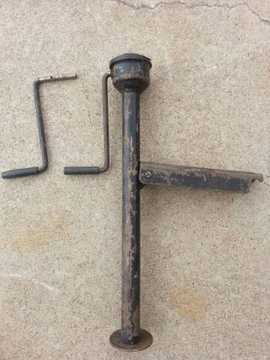

                            Another local useful tool that gets borrowed is a bungee remover. I posted this previously but basically it's a single shaft car jack that uses an internal screw to move a side arm on the jack (raises the car from a side mount on the car). A crank handle on top turns the screw. The builder put a bottom pin to insert into the Taylorcraft truss, and welded a chain attached between the moveable arm and the edge a grooved pulley rim curve up that fits the diameter of the bungee cord. The partial pulley rim is inserted under a bungee on one side and the jack extended which lifts the pulley and bungee off the truss mount.
                            The pull chain is welded to the jack arm close to the jack to minimize tipping sideways. Still it needs to be tightly held. It can be used to install bungees, but it takes a few landings to center them on their supports.
                            Saves the bungees when installing and removing floats.
                            An example of the jack:
