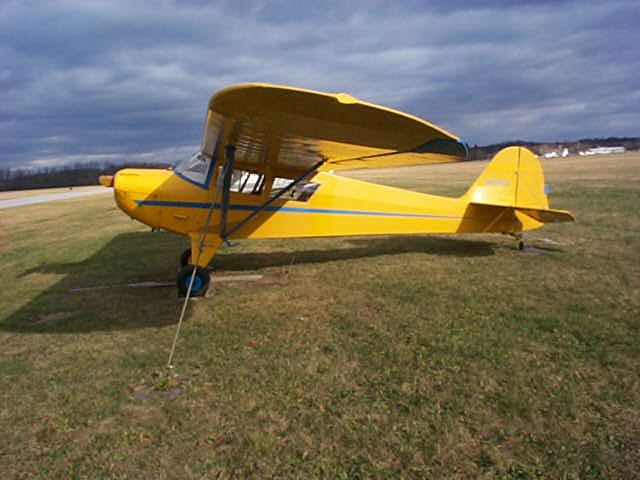

Fellow Crafters, I'm sure you have heard about the infamous "STRUT ANGLE" where the struts angle back from their attach point to the Fuselage attach point. There has been much discussed in the past about this, and Alaska Airframes even went so far as to post procedures for measuring this angle, as apparently there are differences out there between aircraft examples.
My question then is: Have we come to any general accepted value for this angle, or are they just a varied as the aircraft they represent.
My angles are Right wing 4.0 degrees Left wing 4.4 degrees. I would be interested to hear what other Crafters have found. I'm taking the front strut not rear.
