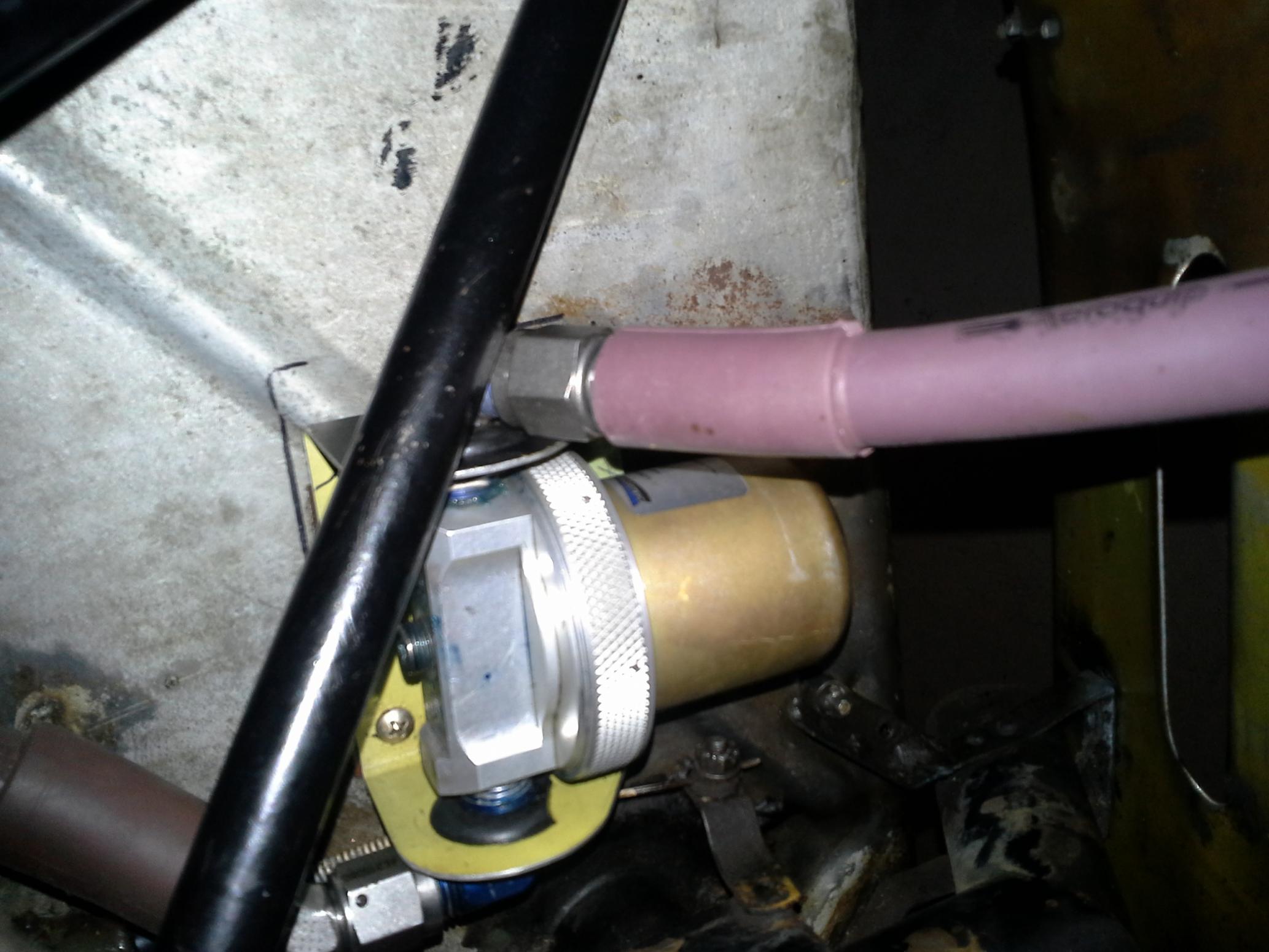

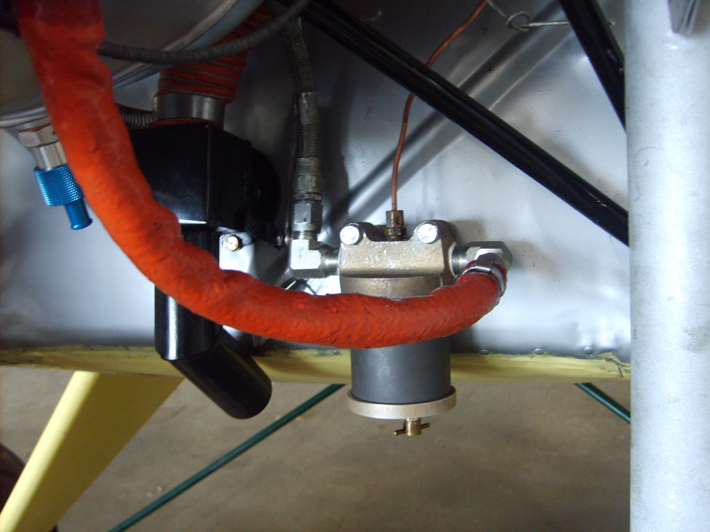

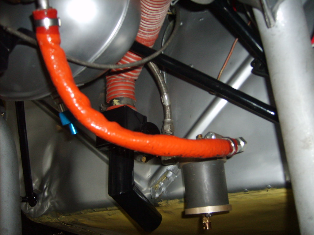

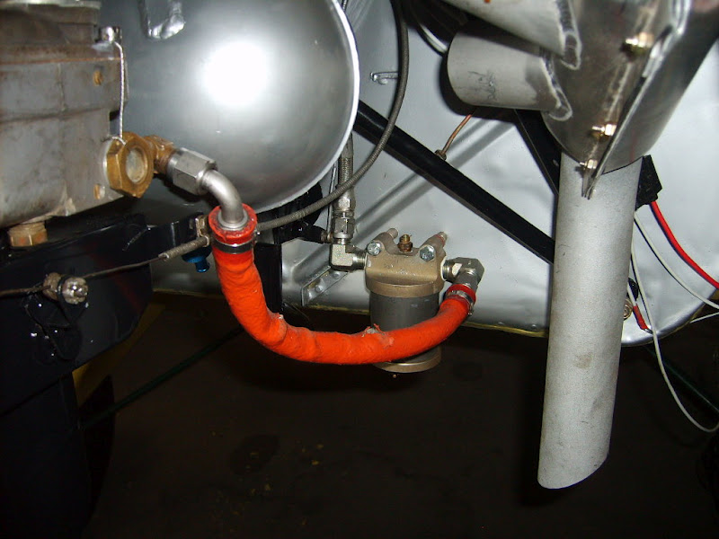

I got a PM from Ken asking for photos of how i routed the fuel lines with the luscombe exhaust so here they are.the gascolater is mounte lower then it was on the engine mount so i can reach under the boot cowl to sample the fuel.Also it's the lowest point in the fuel system.

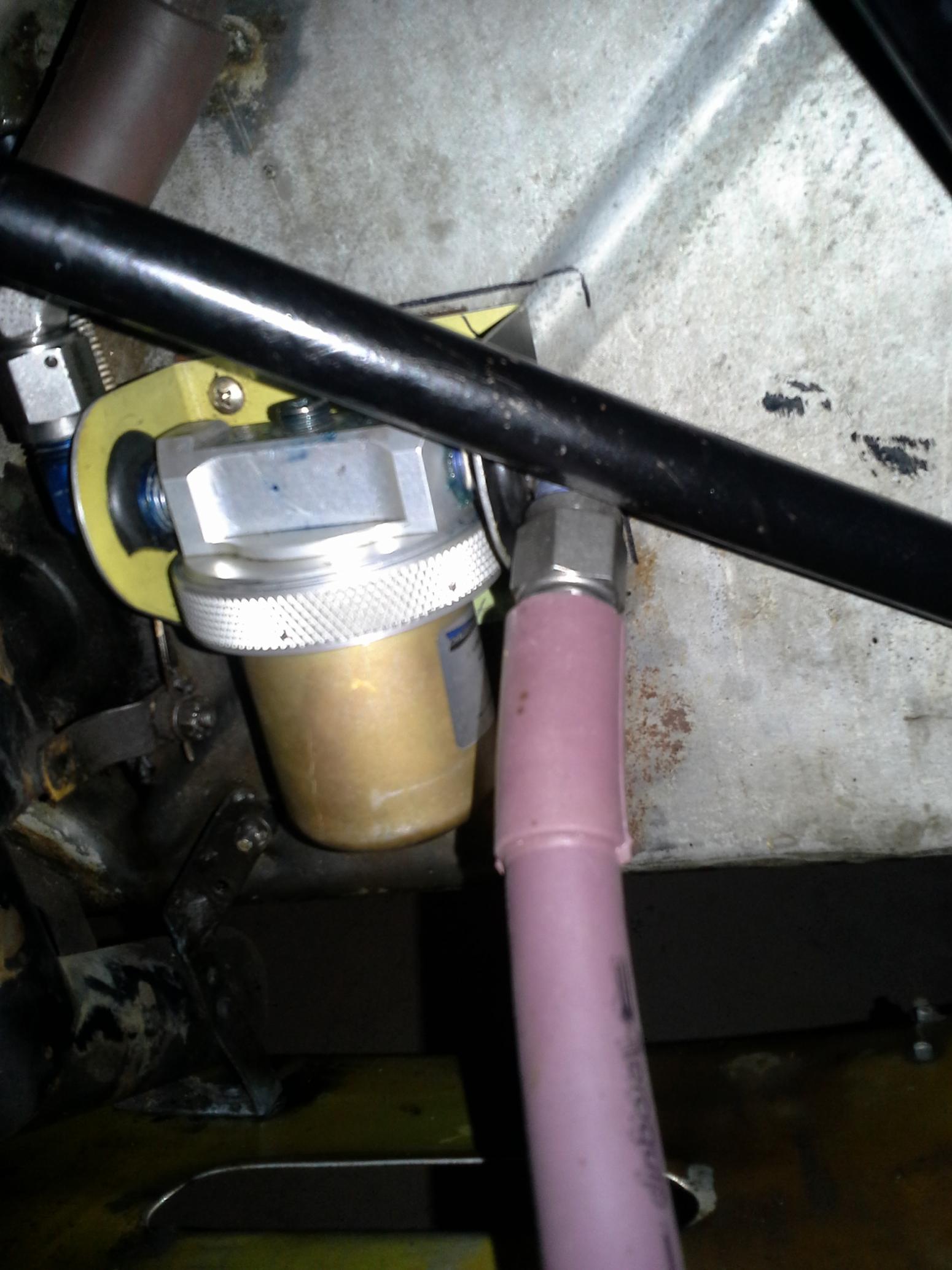

I agree with Miguel. Here is the location I mounted mine. still the lowest point in the fuel system.
OOPS! Sorry for the rotated picture.Last edited by barnstmr; 09-10-2016, 13:52.Terry Bowden, formerly TF # 351
