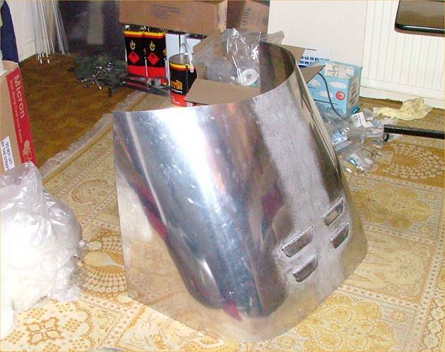

        Like this one ?
        Cost me a bunch, from the local automotive panel-beater.
          Re: Prewar Cowling Alloy/Temper?
          Nice! I like the louvers. I'll give it a try, and probably end up taking it to my local panel beater.
