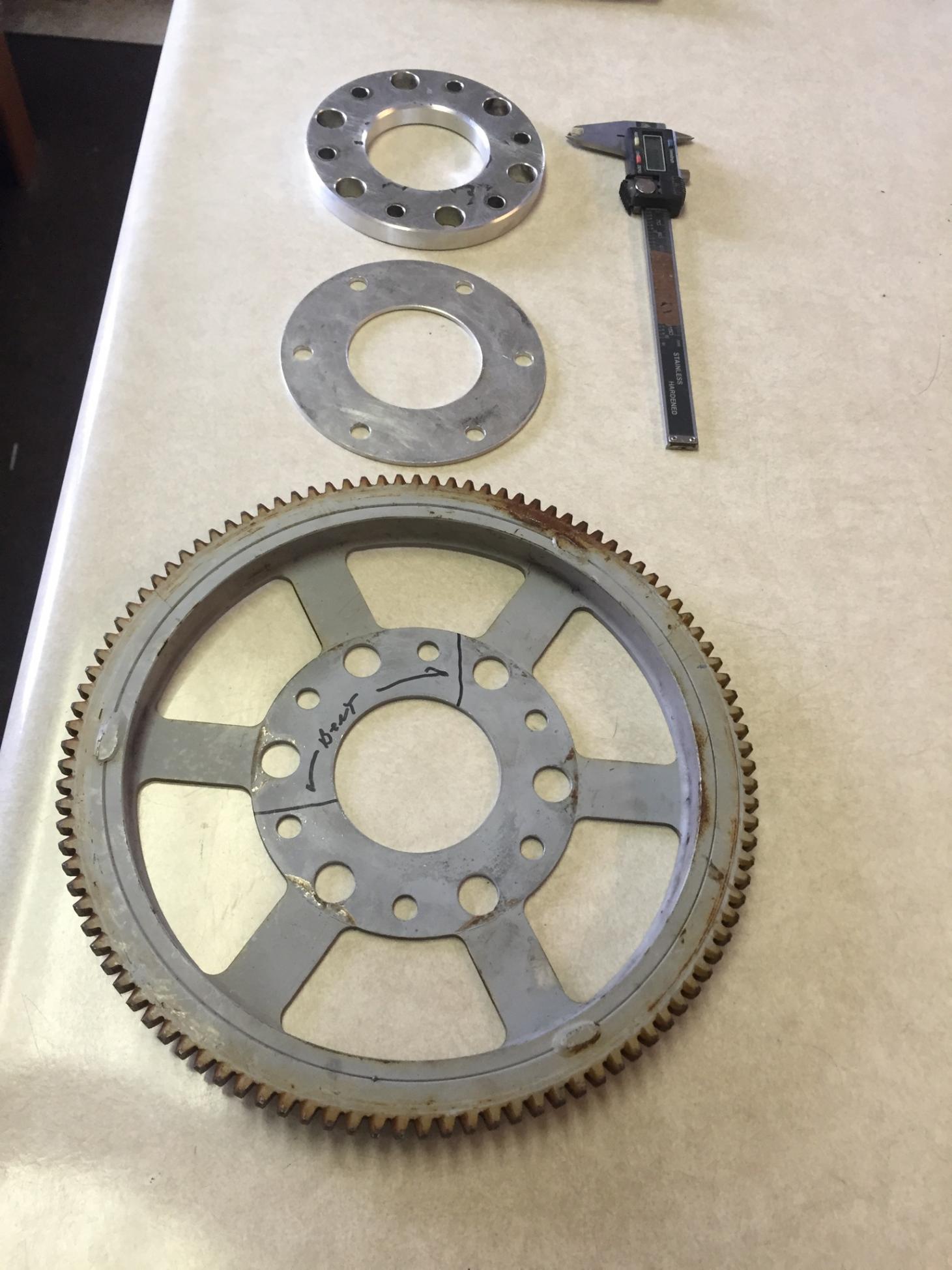

            Here are the three pieces that went with that hub.
            First that one at the top was against the hub and that is .502 thick with I.d. 2.658
            Then skinny one is .120 thick with I.d 2.666
            Then ring gear .120 thick with I.d 2.662
            That spacer against the hub has a slight bevel to it, and one can see where the hub was gouging it with the broken edges.
            Anything else, planning on going airplane camping on some river bottom in the mountains this weekend so if I don't answer I'm away for a bit, doing my first bush landing.

              Tell me something is there any evidence that the spacer was installed upside down when the old prop was on?
              Dave.

                I see three hub pieces in Eddie's picture when the normal tapered hub adapter lists two...the main hub #3745 and the outboard flange #3991. What's the stacking order of assembly and where does the third spacer go? Can I assume the thick spacer at the top is a starter ring gear inner spacer to allow the outboard ring to clear the cowl?
                (PS- saw Eddie today and he survived his bush trip and big fish)
                  Re: Adapter plate rest of the story
                  I think that the spacer goes on first because Eddie said "First that one at the top was against the hub and that is .502 thick with I.d. 2.658" in his last post.
                  You have a good question Gary.
                  For my purposes of modeling I need to know (assuming the spacer goes against the hub) if the spacer was installed upside down with the prior prop.
                  However your question makes me think of another thing to ask Eddie and that is what was the assembly sequenced used with the prior prop?
                    Eddie's probably enjoying the fine Alaska weather this weekend flying again. If I see him today I'll ask re the sequence but likely he'll have an answer soon. I also wonder what the prop position was relative to the starter gear that's apparently warped? I gathered from a discussion yesterday with Eddie and Fred that there's not much info on the longer prop that was installed prior to sale. The former owner would have to be asked.
                    That whole assembly puts the prop further forward on the hub than normal (via the combined thickness of the spacer and ring gear)...maybe the resulting longer arm could magnify any inherent imbalance in the components and stress the base that cracked?
                    Edit: We may have walked this around before, but it appears there's two systems...one for flanged cranks and one for tapered. The tapered model uses the spacer likely between the adapter hub and the ring gear. The flanged crank apparently does not based upon these pics: https://www.facebook.com/SafestartStarterSystems/ That's why there are two sets of holes in the ring gear...smaller to fit the adapter and bolt size on the tapered, larger to fit the flanged crank's forward bushings that engage the recess in the prop.

                      I guess now I have third inquiry, does the spacer have chamfer on both sides of that hole in its middle?
                        The order when we took it off was the thick spacer up against the hub, then the thin one then the ring gear.
                        Yes the spacer has the chamfer on both sides.
                        We cannot find any info on what prop was on there before, I will try to get this answer.
