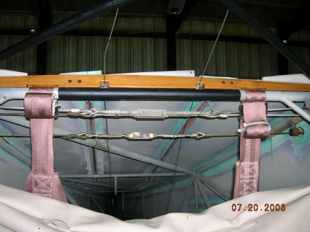

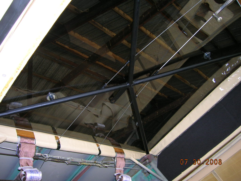

    I've just received my STC SA661AL package from Greg. I think it's going to go in great! The instructions are well written and it only takes cutting the fabric (if you're not doing it as part of the rebuild as I am) and welding in four attachment bolts to the overhead cross tubes, shortening the stringers and moving the attaching brackets and replacing the rear former. The 1/8 inch plexiglass (I bought a 4X4 smoked piece from Aircraft Spruce) will need to be purchased. I can't wait until I can start it! Of course, a 337 signed off by an IA will need to be submitted to the FAA.

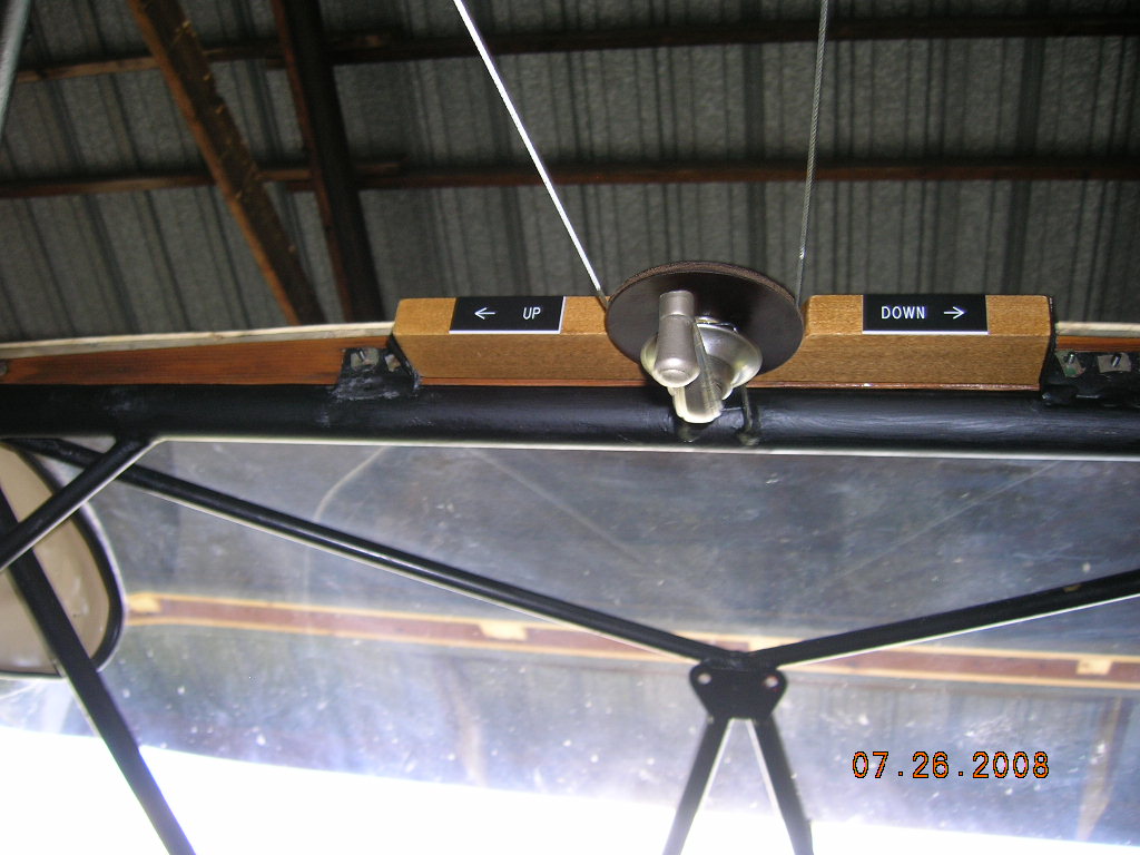

      The Clayton skylight has been everything I'd hoped for, making for a roomier feel, allowing a great view during steep turns, and exposing the trim cables for those times when only hands-on to the cables is warranted. I don't remember if the STC describes, for a rebuild, welding a couple tabs on the rear cross tube, similar to the front, to attach the rear former instead of the fabric wrap method, but I reminded myself to do that should the opportunity ever present itself.
