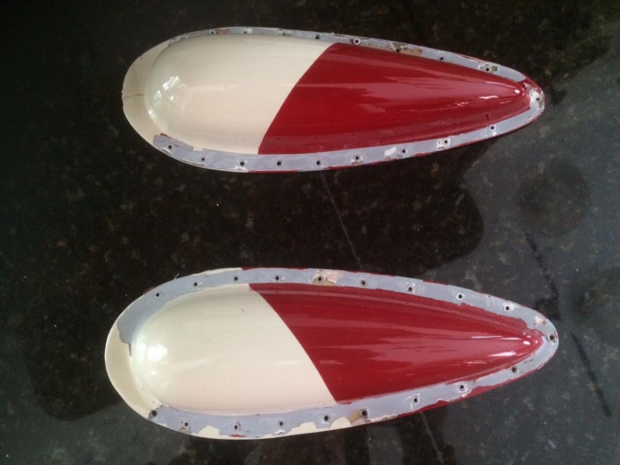

        I just replaced my fiberglass cowl bumps that were the same design as yours. See link below. Skip to Page 5 of the thread.
        Registry of Members Taylorcraft Airplanes. please post only about yours, Replys and comments will be deleted.
        I've replaced these fiberglass bumps twice and repaired them twice. I got tired of diddling around with them.
        I bought the replacement fiberglass ones from somebody on this Forum about 8 years ago. But I can't remember whom. They were $25 each and required a little filling and sanding before they were ready to install.

                Sorry Tim C.
                My intended point was not to say that you should make new bumps out of aluminum.
                My intention was to say that I had identical bumps to yours and that I got them from somebody on this Forum.
                And therefore, perhaps you can find that person and get some repolacements ones yourself that match your existing setup.
                If you want, you can have my old bumps for free. See pic below.
                They are not perfect. But if you can't find new ones, they may be better than yours.
                If you read my registry entry, you'll already know that this last time that I took them off, it was not because they were cracking. Rather it was because the edges of the holes that they were covering were interfering with my spark plugs and I had to enlarge the holes and cover with a bigger bump.
                Tim H.

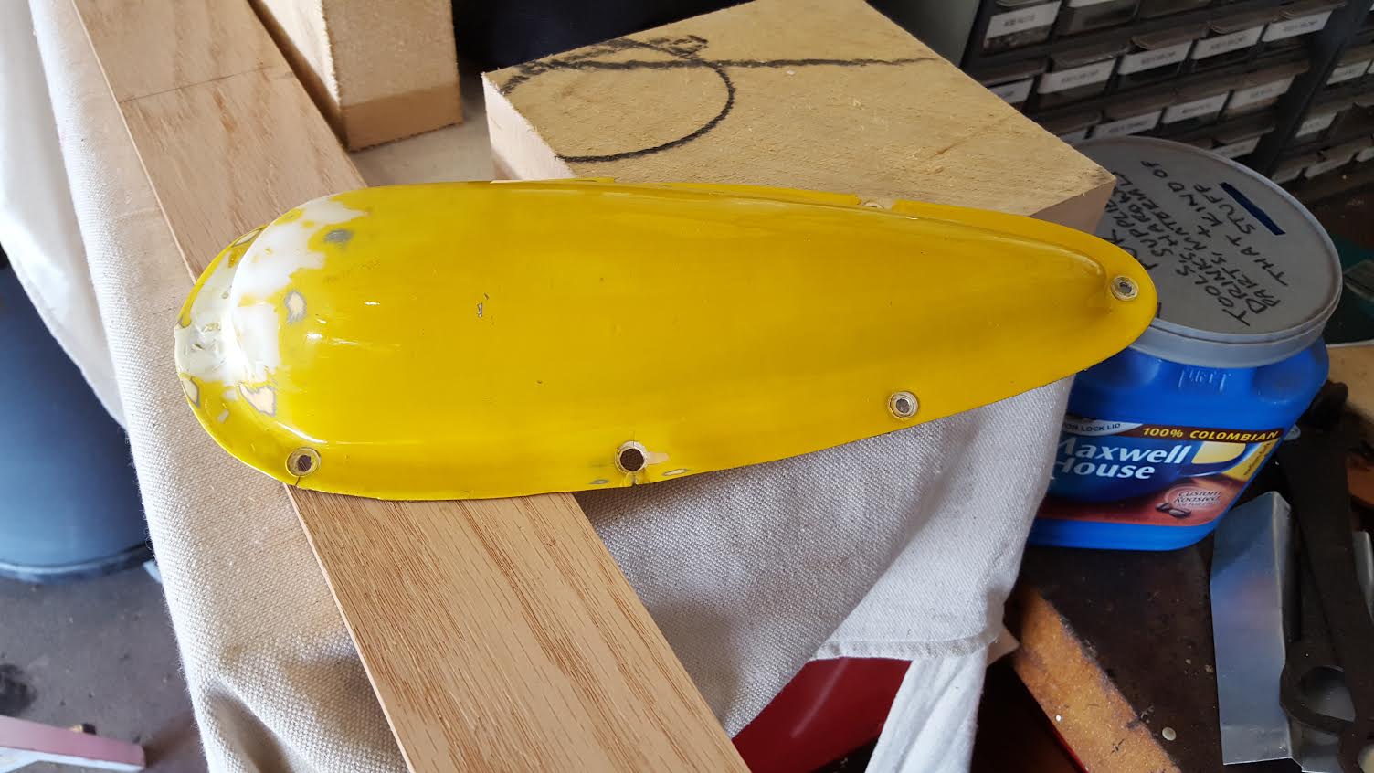

                  Re: Spark plug cowl bumps
                  When i needed to make the bumps for my plane i made the buck(mold) out of a piece of oak with a wood rasp cutting bit from harbor freight and then hammer formed the alum into it. I used 3003 H0 .032 alum. You will need to take a torch and annaeal the alum as you are working it to shape if you try to go to full depth first time it will more than likely tear. You blacken the alum and with a soft flame heat the alum just enough to remove the black soot off the surface, you will probable ruin a few at first i did but it will come remember the final product is going to be only as good as your buck. I used a rounded plactic hammer but the round end of the ball peen will probable work slow and easy.

                    Tim,
                    I haven't had any luck finding new bumps and I'm parked until I find something. I'll take you up on your offer. My address is 91-1069 Noholike St., Ewa Beach, HI 96706. Please let me pay you for the bumps and shipping.
                    Mike, with the information you shared and Tim's documentation, I'll eventually give making metal bumps a go. Work has left me very little shop time until late February.
