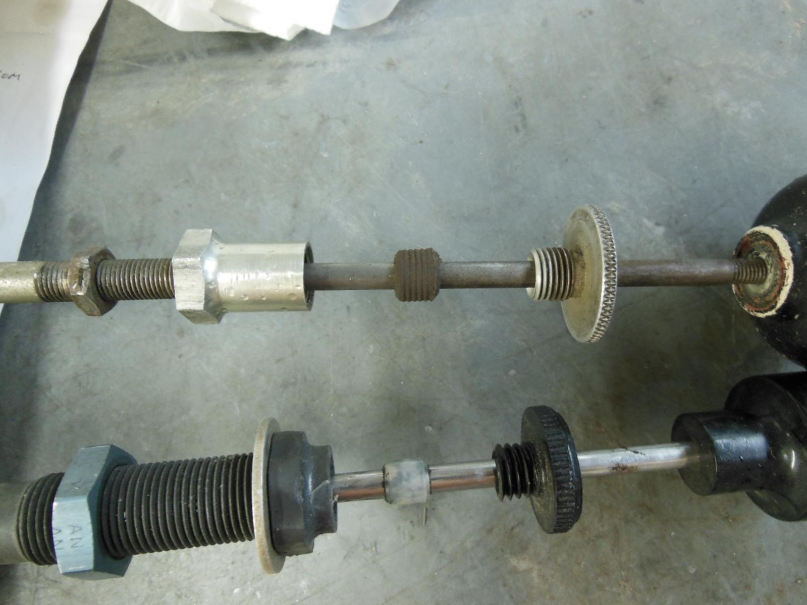

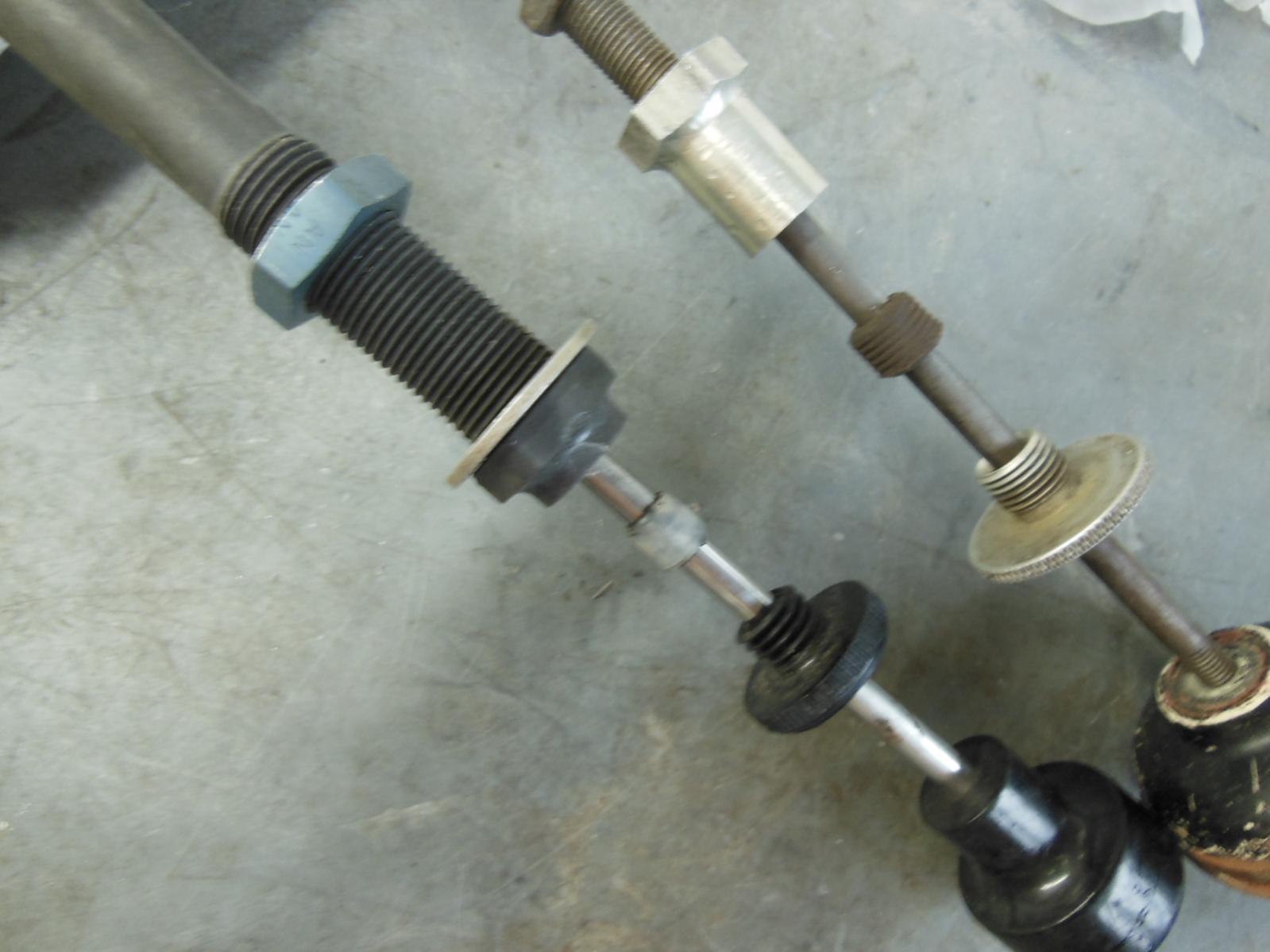

        Here is a picture of a Shakespeare and a Cessna throttle.
        The Shakespeare has a rubber ferrule, you can see it and it has ribs on it and is brown in color.
        The Cessna one has a nylon ferrule and it has one split in it.

            If you look at the ID of the silver one you will see the smooth countersink. There should be another one in the base nut that clamps the unit to the panel. I would guess that the rubber ferrule probably didn't have the "ribs' when it was put in originally and those are threads pressed into the rubber. If you make a short piece of brass tube that is snug on the solid shaft section of the throttle cable and run a split length wise in it when you turn the knob in the countersinks will squeeze the tube tight around the throttle shaft. The only hard part is getting the length of the split tube right. Too long and not enough threads catch. Too short and the threads bottom before the split tube pinches the shaft.

              The rubber ferrule has ribs not thread impressions, they have no pitch and are square.
              That's not so clear in the picture I posted.
              Anyhow there are some pic of two cable systems.
