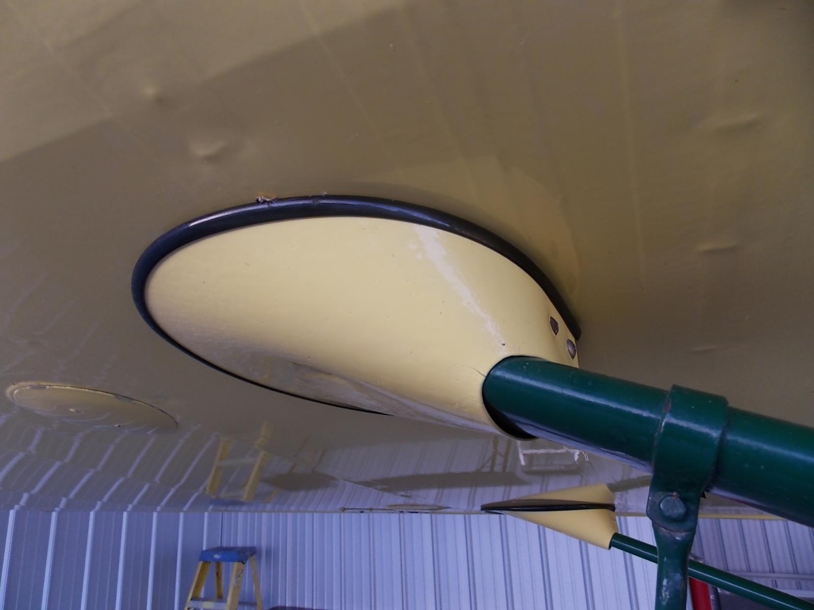

        This is what Robert is talking about these came with the struts that were bought from the factory in 1980 and were used in the f19.They are plastic not metal.
        1940 BLT/BC65 N26658 SER#2000

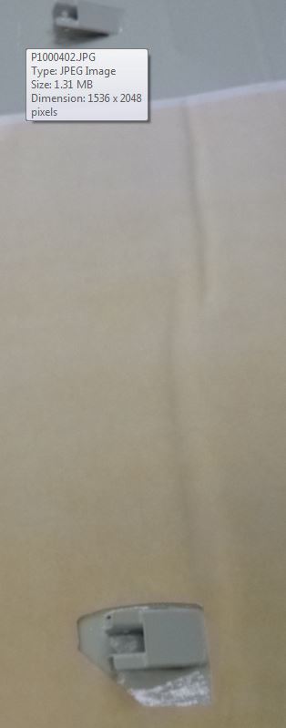

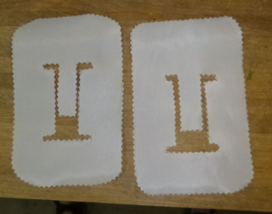

            A couple of photos of my strut attach fittings.
            I previously had a real problem with insects finding their way into my wings.
            So I strove for a tight fit of the fabric to the fittings.
            Tim Hicks
            N96872

              I have metal fairings that look like the plastic ones above on my 46 BC 12 D
              L Fries
              N96718
              TF#110
