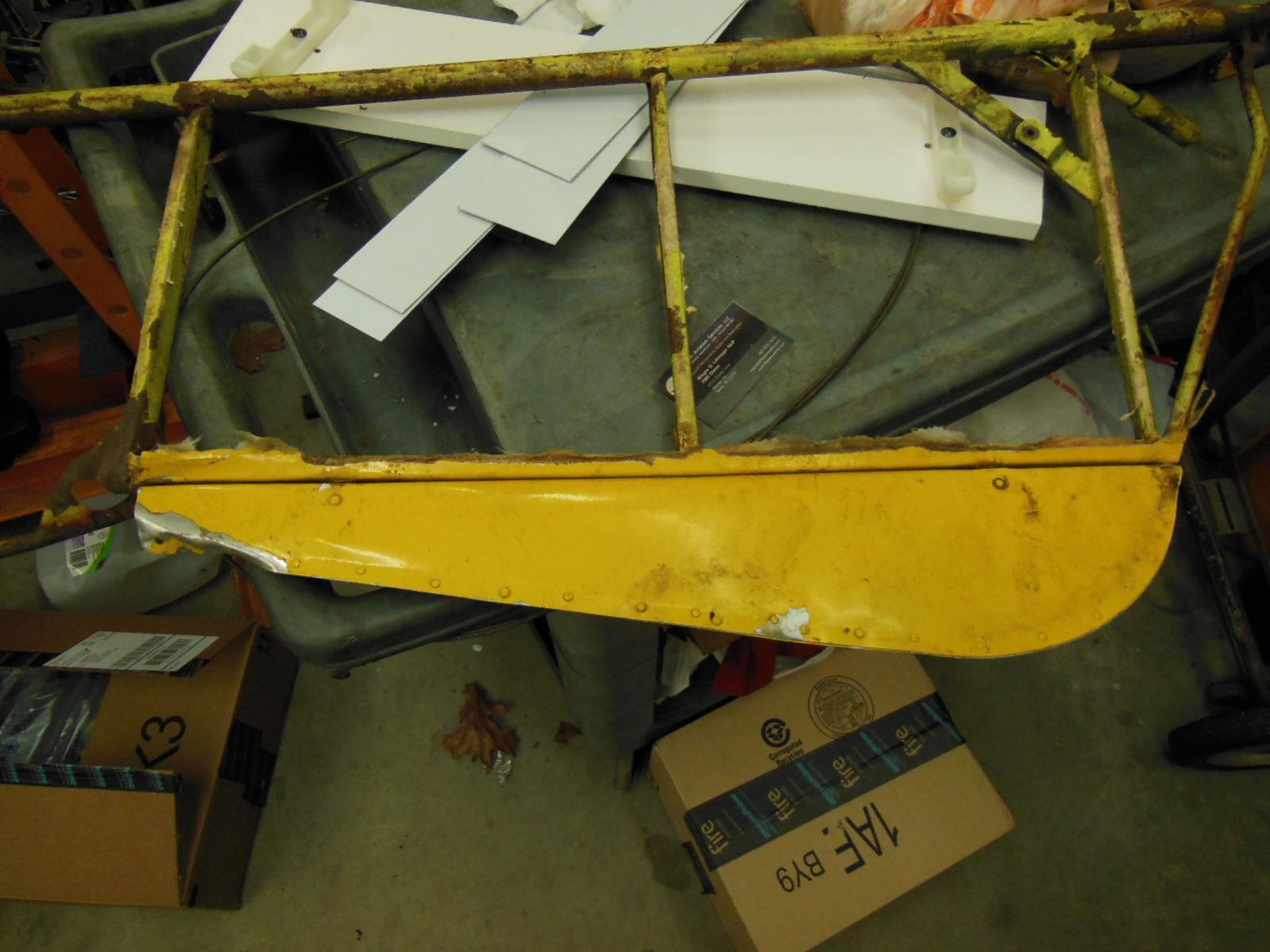

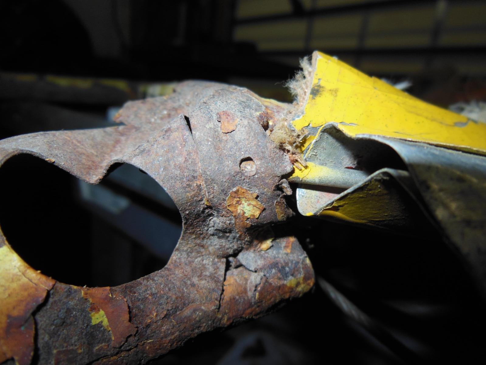

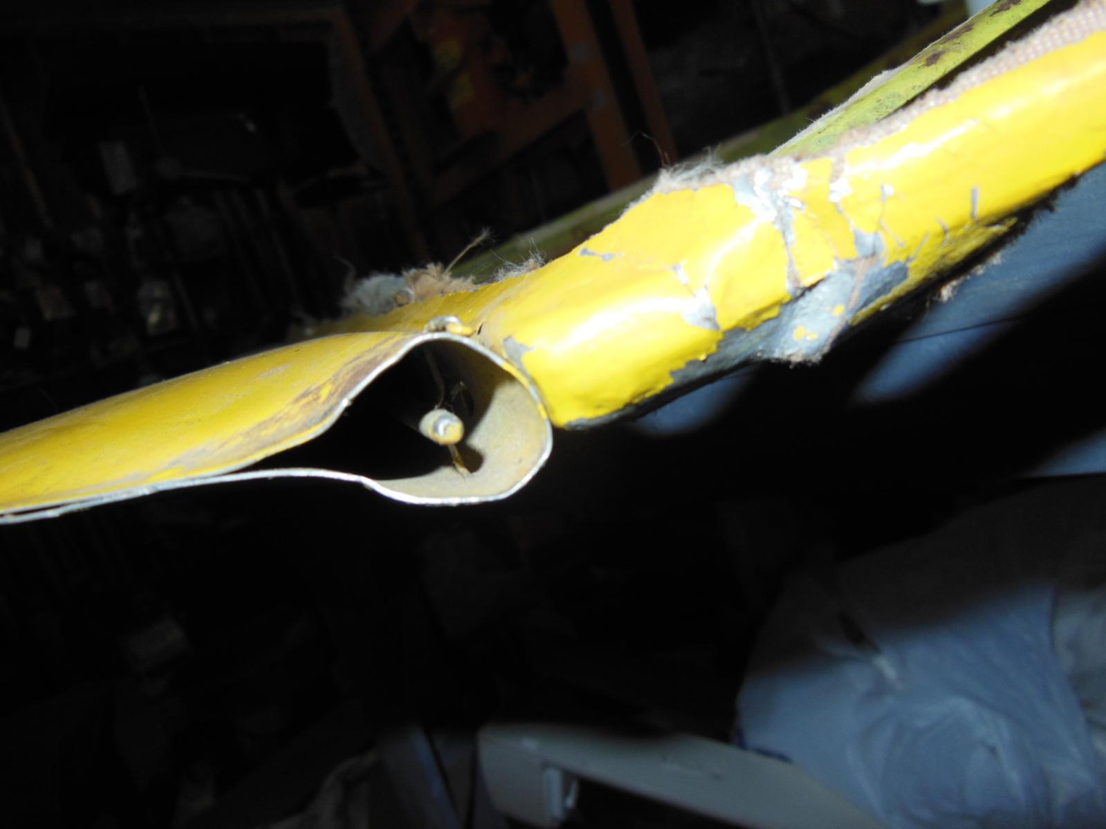

      I attached some pictures of an elevator with trim tab still on.
      Notice it has a wire on inboard end as Tom pointed out.
      Also notice that it has a unused cotter pin hole on the outboard end.
      I suspect that folks cover the outboard cotter pin hole with fabric and don't know what to do and then devise a workable method like safety wire on the inboard end.
