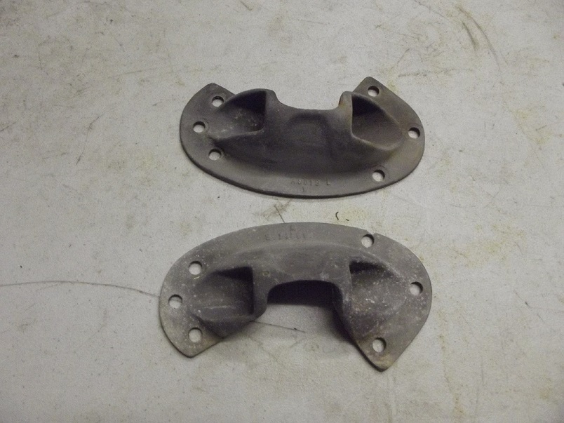

      Found my original cast brackets last night. part numbers are even legible, no cracks. Might approach our local foundry...or at the very least I'm going to try to make a couple of casting molds myself.

        Those brackets are getting really rare! There are (or were) lots of cracked one around, but good ones are different. I have a set and a second set of welded steel ones. I seriously considered making a mold to cast resin around the welded ones so they would "look" original once painted. Wouldn't be hard to do at all and no one would be able to tell the difference.

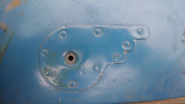

        Got to find a set of original "Taylor Birds" for the outboard sides of the pants. It was a doubler riveted to the side where the outboard bold goes through.

          Is this what you're referring to? They are kinda-sorta attached ;-)...but if you'd like I will gladly make a tracing/pattern for you and send it east....easy enough with them in the bench and off the plane...looks like a simple thing to gin up, if your hands are steadier than mine anyway.

            Could you post a tracing, or maybe a picture with a small rule for scale? I'm thinking one could make a guide and cut them with a plasma cutter. Even easier with a CNC mill.

                That is the Taylorcraft Bird. They were really pretty simple and were just cut from sheet aluminum. I understood that they were first used as a doubler over the wheel nut so the bolt wouldn't tear the pant. I have one tracing, but a second that matched it would be nice so we would have verification someone didn't just make one from a photo.

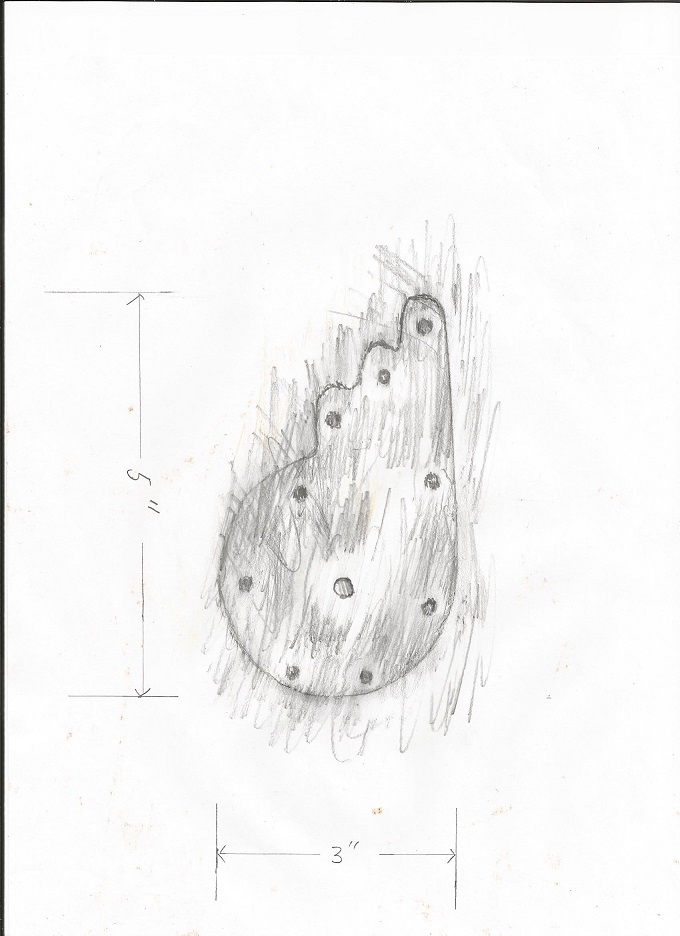

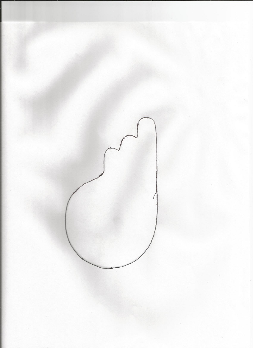

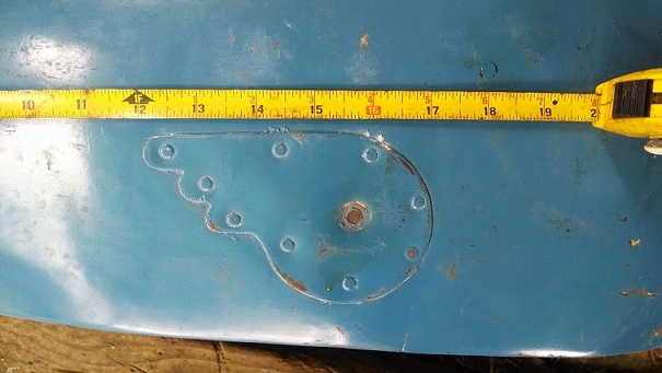

                  Scans of a trace and a rub, and a pic with scale...of course the "trace" is bigger than actual-outline..."rub" is accurate. Didn't have much time...can make a better attempt if you'd like or just snail-mail a hard copy if it makes using it easier...PM your address if you want to do that.
