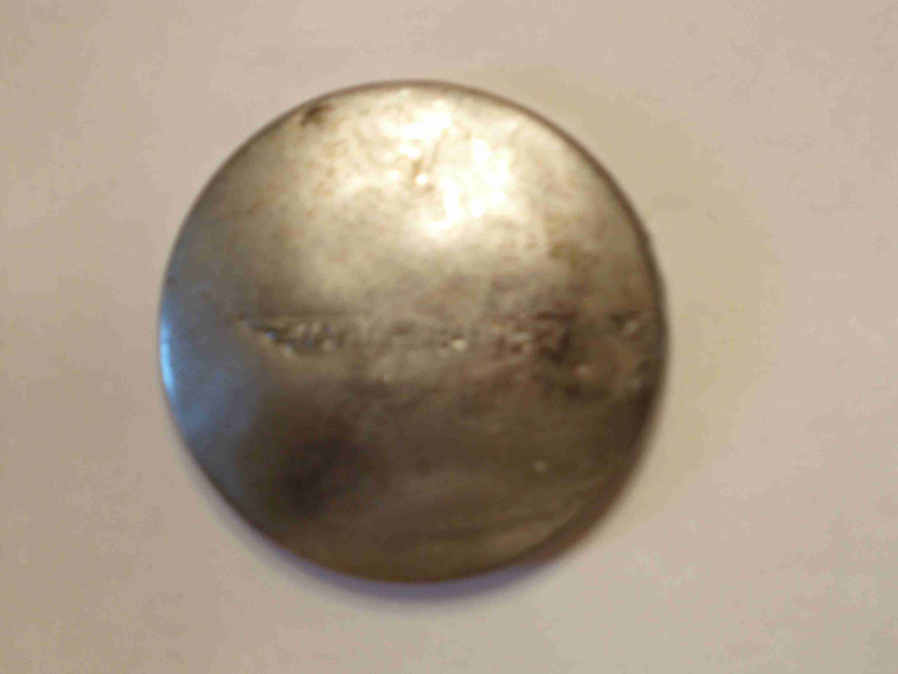

    I have found a web sight that has 2 1/2 inch steel freeze plugs that would fit the center of the coloum but no brass plugs, they have several different ones and I am gonna order a couple of different styles to see what is closest.
    If anyone wants to start looking for themselves do a search for dorman auto products and after u find a catalog look for freeze or expansion plugs
    Re: Horn button
    For anyone a little confused, he is talking about teh center hub covers for the Banjo wheels. I pulled the micrometer out and the ID of the cap is 1 5/16" (the diameter of the wheel center the cover goes over) and 1 7/16" OD. They look like they are about" 5/16" high, but could be cut down to that height if the plug was deeper. They are a little "domed" but we can make the dome part as well as engrave or stamp teh Taylorcraft logo.
