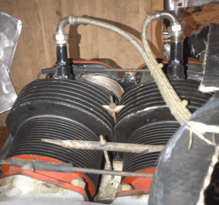

              From my A-65 on my '46 BC-12D with cowl bumps.
