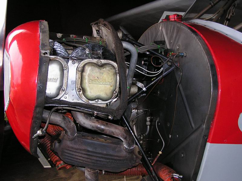

Anyone have any ideas on removing the left bottom plug on my A-75 with Cessna 140 exhausts? I can not get a socket over the plug for hitting the exhaust tube. The socket I am using is a 3/8 drive deepwell, which just fully engages the hex on the plug. This is the shortest socket in my box. I would appreciate any suggestions on sockets that might be available which would eliminate removing the LH exhaust.

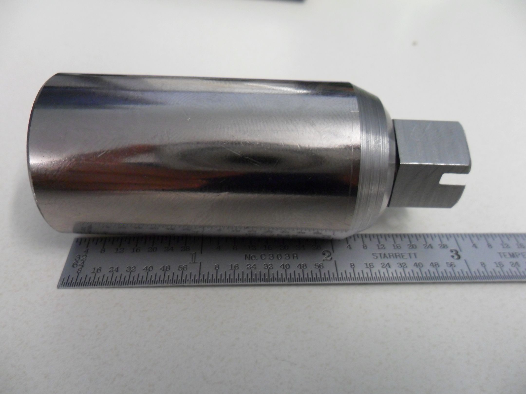

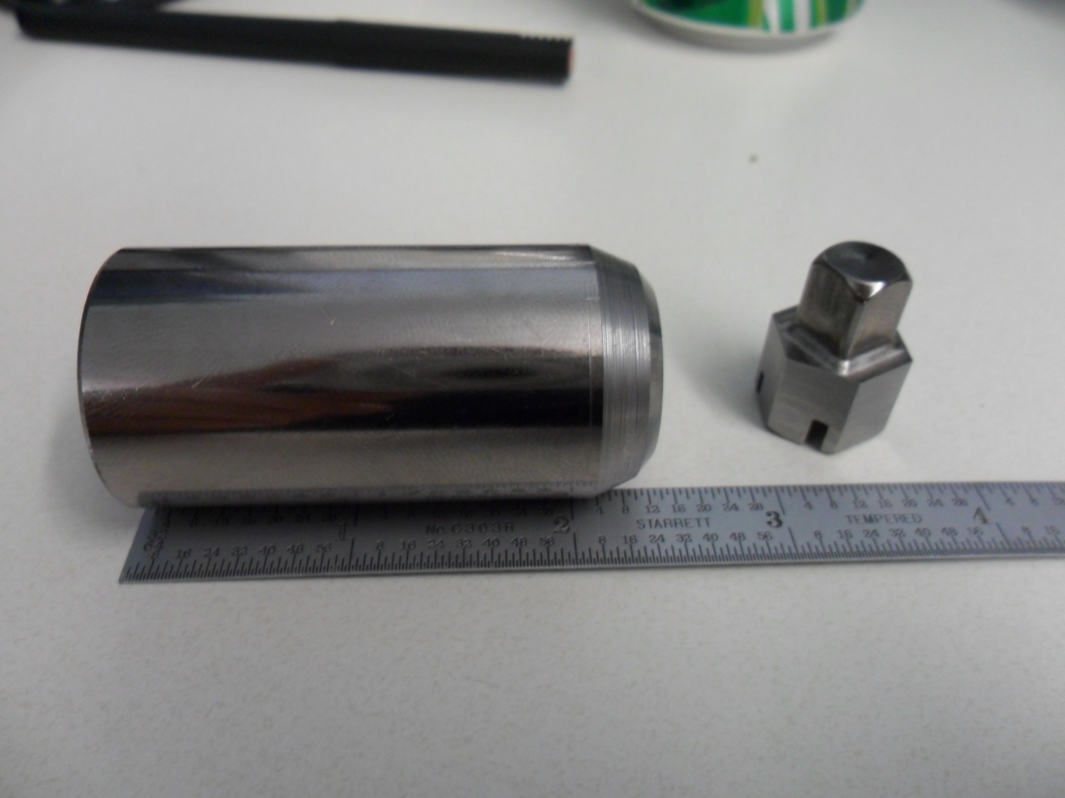

I appreciate the input. A box-end will not reach deep enough. I modified a 3/8” drive x 7/8” six-point socket by shortening both ends and adding a chamfer to give more clearance past the exhaust tube. I also modified a 3/8”-1/2” adapter by milling a 5/8” hex on the end. Hopefully, I can slide the socket on, insert the adapter and loosen with a box end. Sure hope it works!MIKE CUSHWAY
