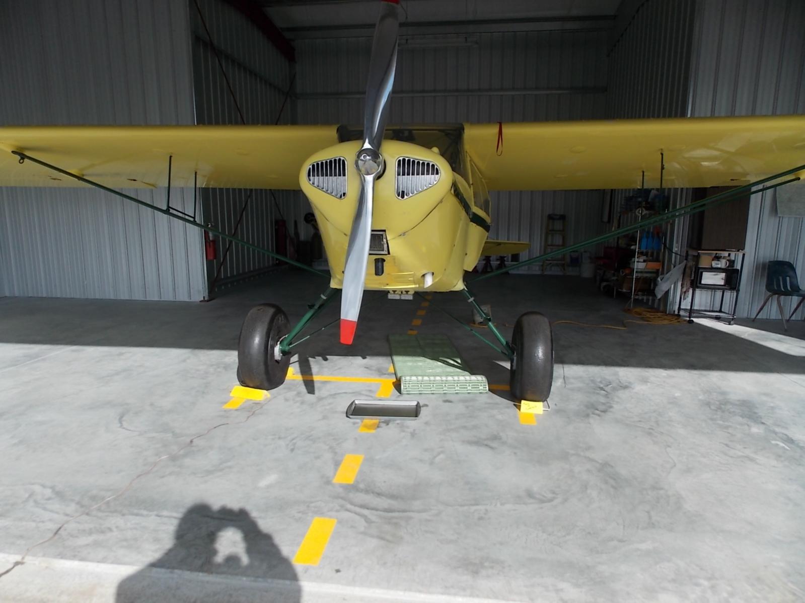

        the type cert for b model shows a 83 in prop the prop in this photo is 74 in an 82 in is 4 in more on a side and 26 in bush wheels are not much taller then 8/50 tires
        1940 BLT/BC65 N26658 SER#2000

          Hey!! Finally someone else who likes the idea of a Super Taylorcraft. I have a 46 BC12D with the 0320 lyc 160 hp. I didnt like the noise and vibration of the 82 inch borer so I had Craig Catto build me a 76 by 44 composite 3 blade and I would never go back . It is smoother quieter and 12 lb lighter. Phenomenol initial thrust and great climb performance. I had 850 by 6 rubber but switched to 21 by eight tundra tires. lighter . cheaper and 4 p[ly sidewall. only slightly larger than the 850"s and fit on the same wheel . If you are going to put the heavier engine youwill want to upgrade to the heavy alaska airframes struts. along with many other mods. Drop me an email if you want more info on my conversion. [email protected]
