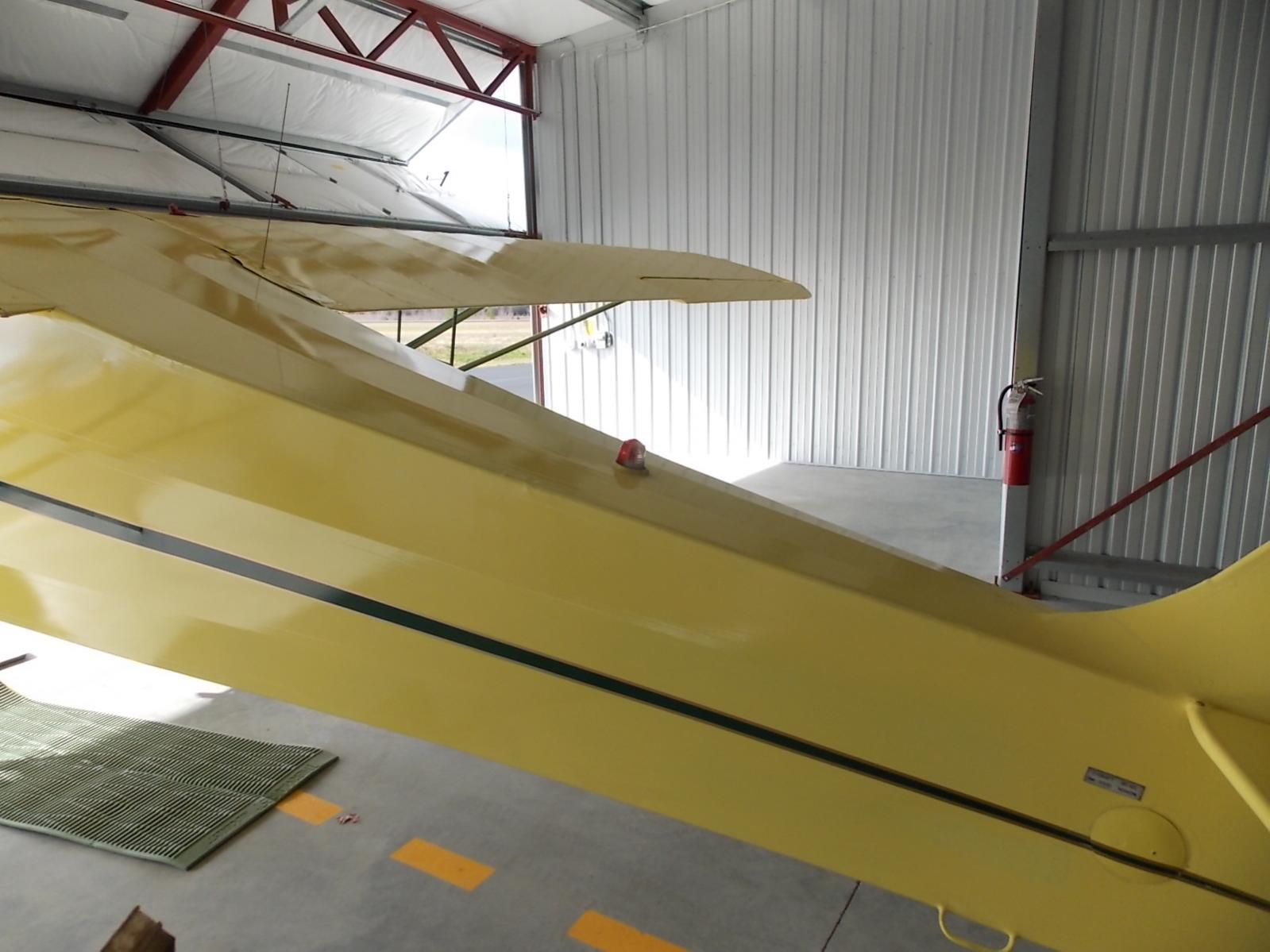

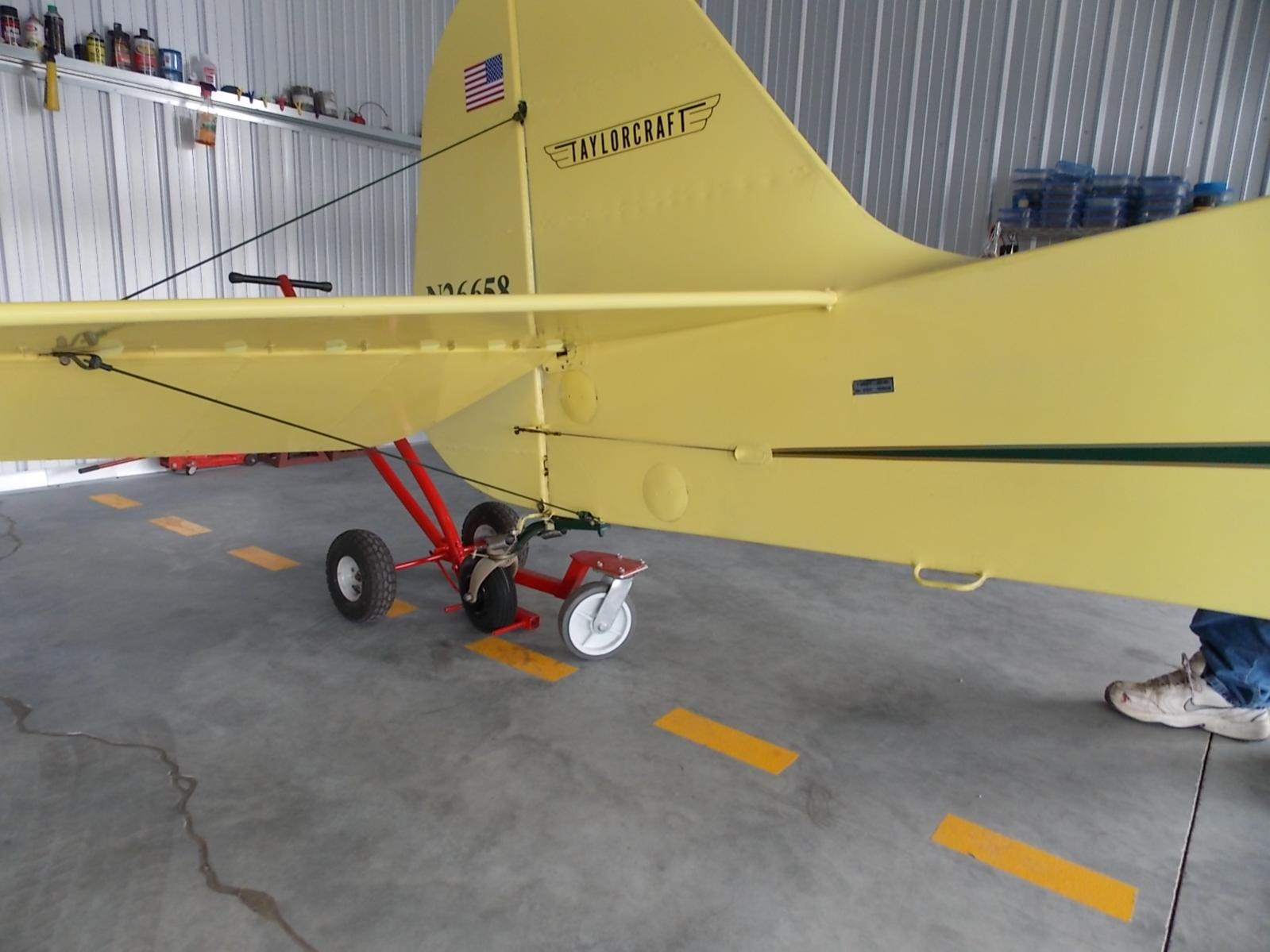

              n26658 has two on it they are a metal tag and state just what Marty said and i have read that they are required in a FAR but don't know what number it was
              1940 BLT/BC65 N26658 SER#2000

                  Marty the man that rebuilt my plane was a Secret Service Agent so that's why it has two he now instructs at Black Water.
