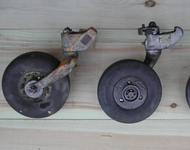

Hi Bird,

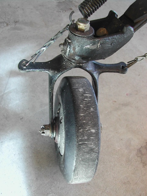

The Scott model 3000 is a non-swivel tailwheel. Chronologically it falls between the early 3-21 non-swivel double fork model and the later 3-24B full swivel model tailwheel. In photo 1, the 3-24B on the right has 2 ears on the tail spring bracket, while the 3-21 on the left has none. The purpose of the ears is to trip the steering arms which throws the 3-24B tailwheel into full swivel. When Scott developed the 3-24B bracket casting, they simply used it on their (cheaper) double fork non-swivel model 3000 tailwheel. (photo 2). Apparently, you have a full swivel Scott with the "correct" bracket, but with a 3000 data plate. Only the names have been changed to protect the innocent….
BTW, The 3-24B later became the model 2000.
Regards,
HT

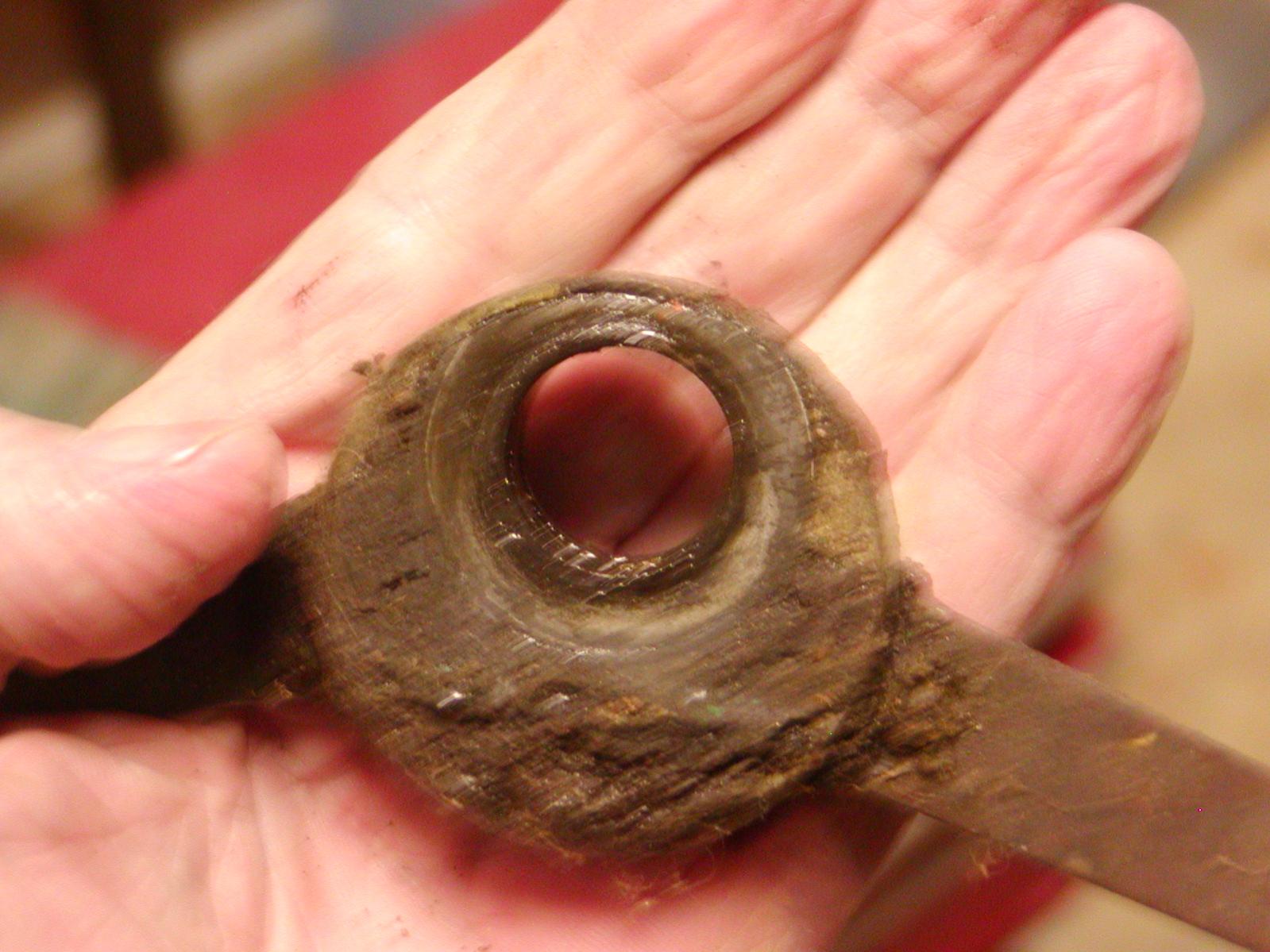

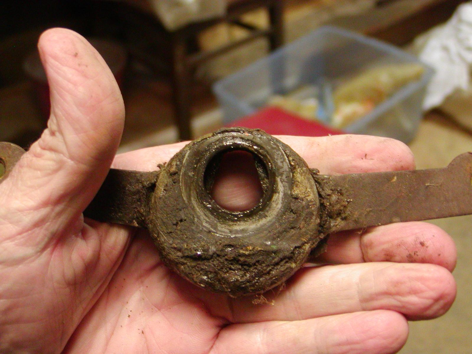

I just took a couple of pictures that show the wheel swivel and the ears in the closed and open position (look in the center hole). Well I thought I had a 3000 the tag is correct I was just a little lazy about getting down on my knees and taking a good look.
So, how does this tailwheel stack up against the others?Last edited by Bird; 03-06-2013, 13:02.
Re: Scott tailwheel
Hi Bird,
To help clarify, the "ears" that I was referring to are the two top, front bumps cast into the tail-spring bracket. When the wheel is pivoted past 65°, the steering arm ( the part in your hand ) hits one of the the ears (left or right) on the bracket. The ear trips the steering arm out of the vertical axle shaft grooves (open position in your photo) and the wheel is unlocked.
As long as the parts aren't too worn out, it's a great little tail wheel. Here's a good article on the model 2000: http://www.popav.com/ListTechArticleDtl.asp?id=84
