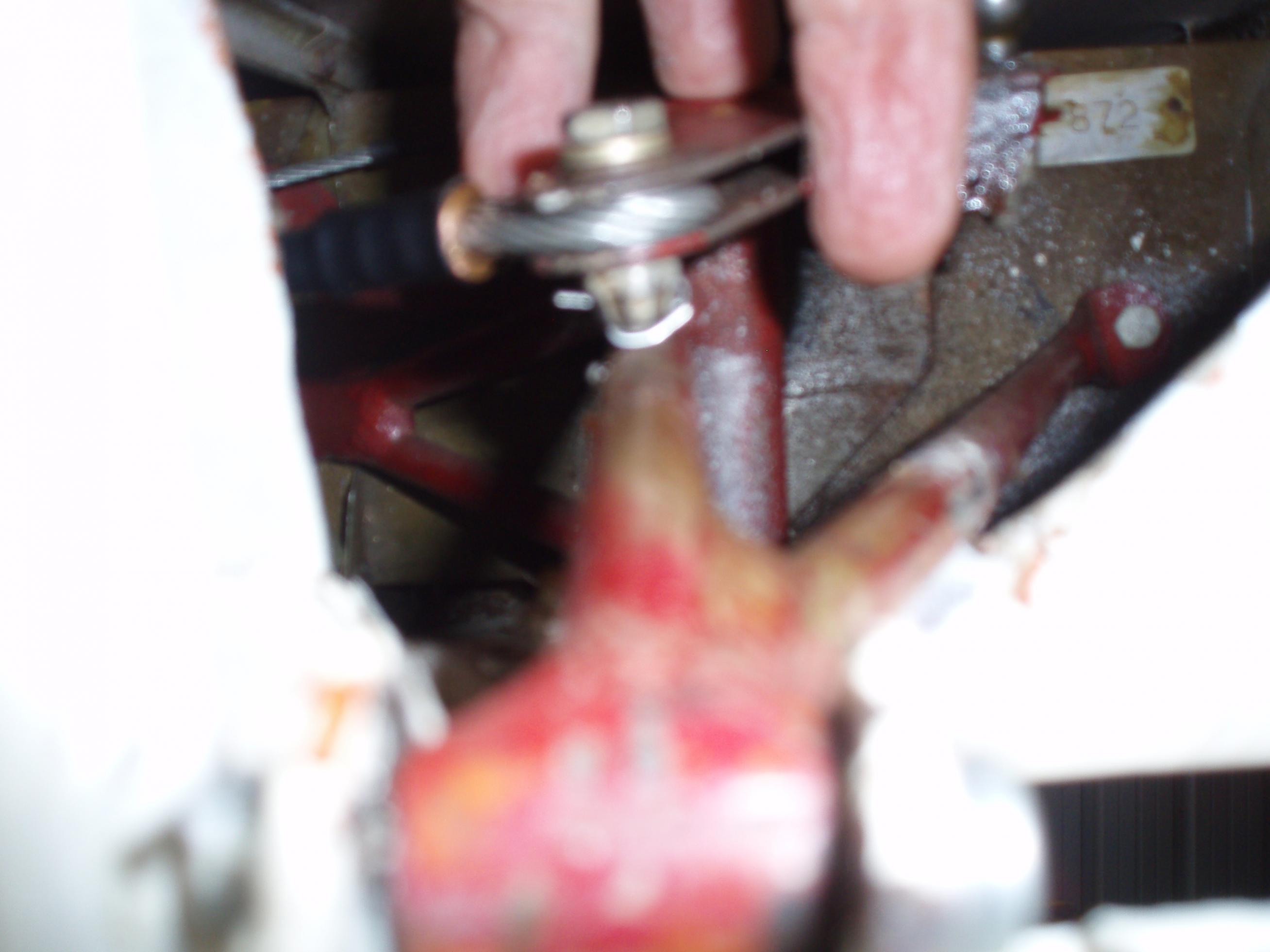

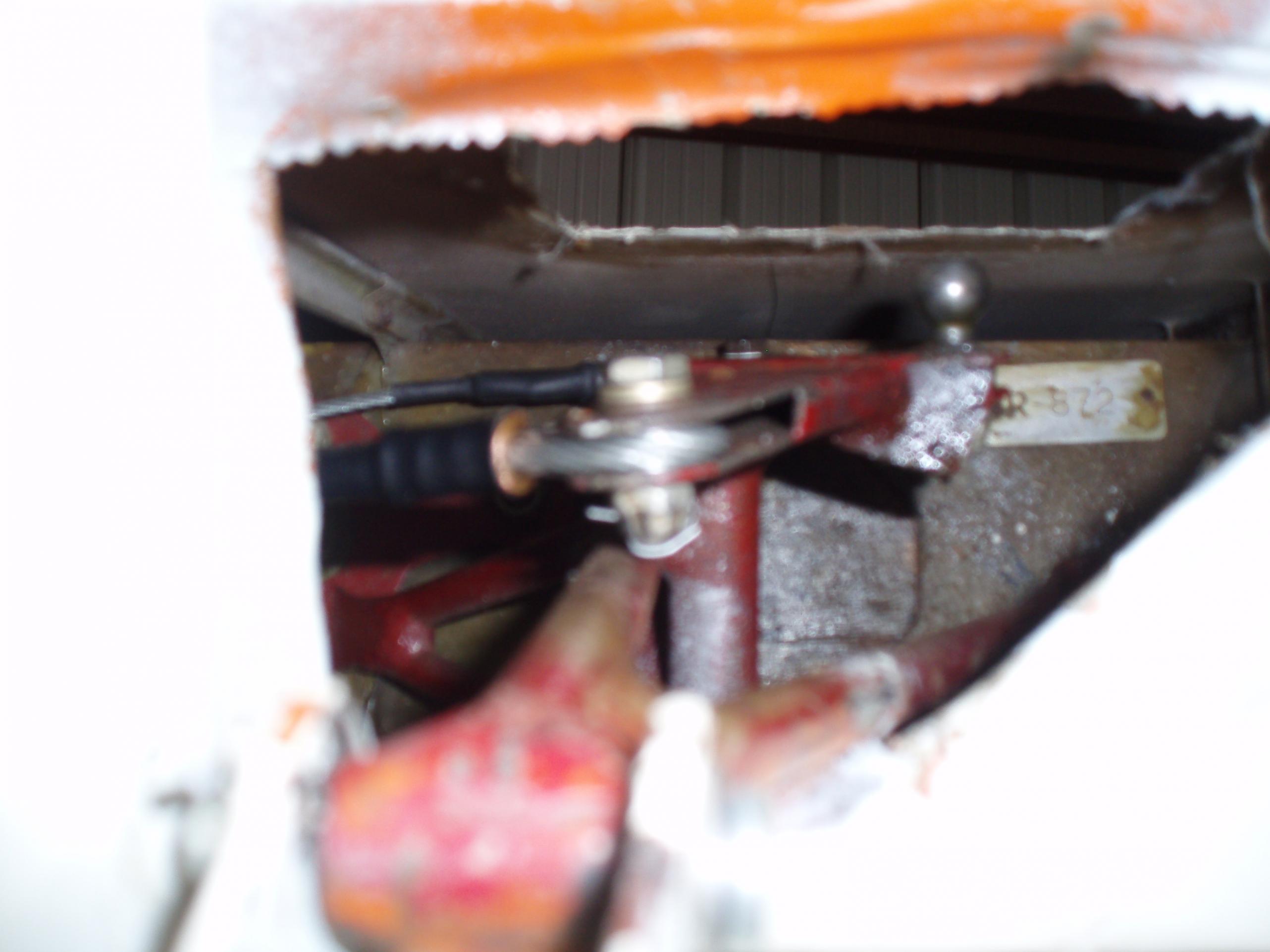

      While I was rigging my ailerons following cable replacement I had the bellcrank to cable bolt in with no washers. How nice! The bolt thread hits the tube and holds the crank close to neutral while you thread the turnbuckle on.
      Did the light just go off? I tried it with a thin washer and it stuck that way too! We need to get the word out to the guys with the welded aileron fittings to take a look. With the aileron down and a flash light it is a 10 second inspection. I went through my drawer of AN-3 bolts with the correct grip and several of them had longer threads than the old AN ones. With one of those in there the threads definitely hit the tube. With the longer bolt it took 3 thick washers and then the threads were in bearing.
      This is an EASY inspection to do, even on a pre-flight and could be a real "gotcha" if anything shifted a tiny bit and you were close to hitting the threads on the tube.
      We need a method to get these things we find out to the tribe. Maybe a thread to alert each other. Not everyone reads all the threads.
